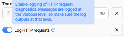

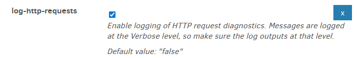

ā€œAdded option to log http requestsā€ as announced at top could show whether Backblaze gave a success return to the upload, but didn’t actually have the file there. Even without having that information, as long as you have a log-file at at least Information, you’d have some file name to go look for. If you raise level up to Verbose and add the new option of
or in old ngax UI which actually gives the option name (release notice usually also fails)
Having to go read all the pull requests is very unfriendly, but at least the name is there.
There might still be some guessing if you have concurrent uploads, but after you see the name that’s missing, you can look for something like upload completion, then see status.
