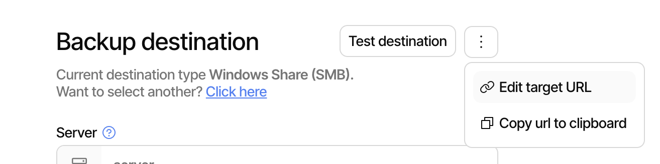

I tried canary because I need to use CIFS/SMB. But when trying it, it works, but I get warnings:
[Warning-Duplicati.Library.Backend.CIFSBackend-DeprecatedCIFSBackend]: The CIFS backend is deprecated, please use the SMB backend instead."
Am I wrong in choosing CIFS (I don’t see an SMB option in the list).

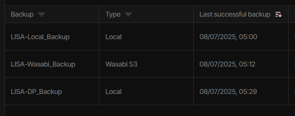

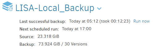

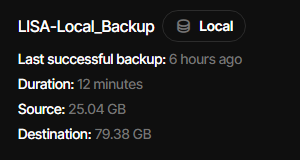

Is it possible to add back the next scheduled run as shown in the old UI?
I also confirm that the en_GB fix looks good now, thanks
Not the best example, but the date is the right way round now :+1:
That is a bug in the UI. It should show both “CIFS (deprecated)” and “SMB”.
I have fixed it for the next version. For now, you can manually edit the connection string. Click the three dots, then “Edit target URL”:
In the dialog, change the leading cifs:// to smb:// and click “Override target URL”. The UI then looks a bit different, but you have the same options. In the next release, it will look better.

Sure! I have added it already, it will be in next release.
Thank you! That worked.

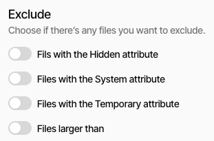

One minor typo in the first option. “Fils” instead of “Files”
Thanks for reporting! It has been fixed in source.
