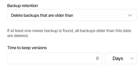

Destination screen on new job create comes up with non-working retention setting:
Submit flashes an alert. I think it might be (from stored alerts) this non-helpful one:
To actually find what it had to say (without ngax), one can watch in developer tools:
{"Error":"Retention value must be more than 5 minutes","Code":400}
so annoying, but easy enough to fix when known, e.g. by setting “Keep all backups”.

Is this different than ngax? It is picking the time-based retention, and expecting the user to enter some amount of days. What would you want it to do instead?
I created an issue for that.
