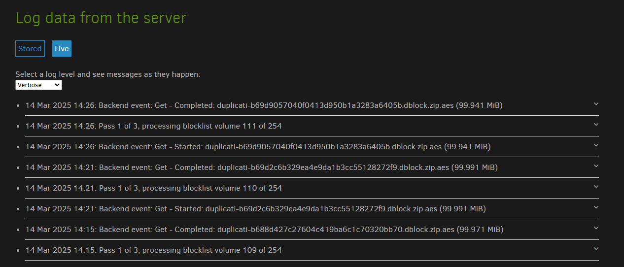

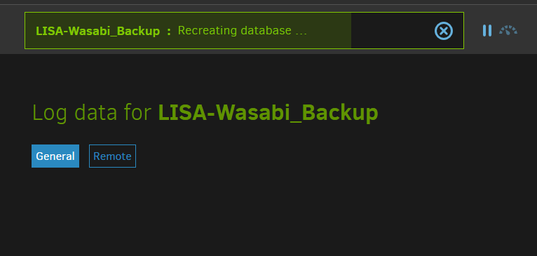

Under the job I ran the Repair job there are currently no logs:
And I know it started and was processing because I saw the same as I am seeing now in the live log:
This is all there is
Sounds pretty weird from a timing basis based on history (which sounds painful):
But if Recreate hadn’t finished, you wouldn’t have a database to give complaints.
Probably need developer input (and live log question, asked twice, also needs it).
It completed with some warning, but it doesn’t confirm if the missing files were successfully recreated:

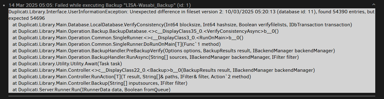

I decided to try running the backup against the new database, but it fails with
  • 2025-03-17 13:01:53 +01 - [Error-Duplicati.Library.Main.Controller-FailedOperation]: The operation Backup has failed with error: Detected 306 file(s) in FilesetEntry without corresponding FileLookup entry DatabaseInconsistencyException: Detected 306 file(s) in FilesetEntry without corresponding FileLookup entry
Any ideas what’s going on? Couldn’t find this message in the forum, and I’ve tried to rebuild the database twice now which takes a very long time with the destination being on Wasabi S3. A repair does nothing.
I get the feeling I’m going to have to purge the entire backup off Wasabi S3 and start again.

Good point. But even a recreate should create logs in the database logs?
Since it is also not showing the backup attempt (which is logged elsewhere) I am thinking that something is preventing the display of messages from the local database.
Do you see any errors from the Developer tools? Can you look in the database in the table “Operation” or “LogData” to see if anything is there?

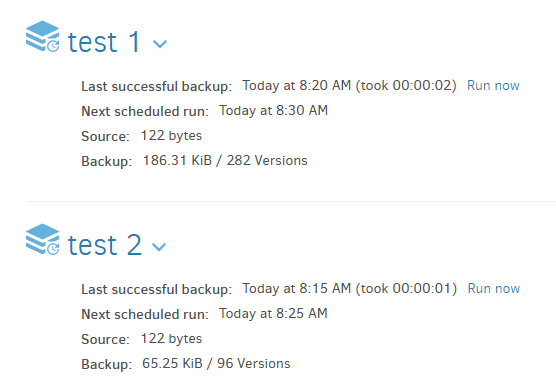

But does the “today” turn into “yesterday” when the next day comes?
I had to check a 2.0.8.1 log today, as I wasn’t sure “Today” was right.
FWIW there’s a documented option for this, but I’m not sure it works:
  --force-actual-date (Boolean): Force the display of the actual date instead of calendar date
    By default, dates are displayed in the calendar format, meaning "Today" or "Last Thursday". By setting this
    option, only the actual dates are displayed, "Nov 12, 2018, 8:01 AM" for example.
    * default value: false
I use --force-actual-date on all my backups specifically to avoid the yesterday/today ambiguity. Works great.
I would never expect to see “today”, “yesterday” or anything similar like “last week” to appear in actual logs, only on the GUI where it’s giving a dynamic current job status. In the actual logs it should always be the exact date in full, otherwise they’re useless, but if that’s the case then they need to be fixed in my opinion.
Where in the many outputs of Duplicati is a change visible? I have it on in 2.0.8.1
System was left up overnight with Duplicati tab open, to prevent browser sleep:
The Today is actually leftover from yesterday. It’s not yet 2:40 today, so it’s not completely ambiguous if one knows the time. In another day of this, it would be.
I’ve been using the global setting --force-actual-date since at least Duplicati - 2.0.7.103_canary_2024-04-19. In my case it shows the actual date of the backup in the web UI as intended [ex.]:
Last successful backup:
    Mar 18, 2025 2:18 AM (took 00:00:58)

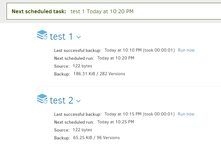

After an easy repro (except for less odd status bar) of the stuck GUI, I’m trimming back. Original case was two tabs with three scheduled jobs on different schedules, with a collision at top of hour. Case hanging overnight was one tab on Server not TrayIcon because TrayIcon adds more noise to Wireshark view. Two tabs leads to mixing up tab requests and possibly adding out-of-order responses from request timings, due to HTTP 1.1 and a socket pool that’s used. I also removed the job schedule conflict, running two jobs at 10 minute schedule, with a 5 minute stagger between jobs, and no actual new version. Previously I had used upload-unchanged-backups. Results:
All the Today are actually Yesterday now, but that discussion was done above.
I got a better handle on watching WebSocket work. Edge devtools has last as:
{"ActiveTask":null,"ProgramState":"Running","SchedulerQueueIds":[],"ProposedSchedule":[{"Item1":"1","Item2":"2025-03-19T02:20:00Z"},{"Item1":"2","Item2":"2025-03-19T02:25:00Z"}],"HasWarning":false,"HasError":false,"SuggestedStatusIcon":"Ready","EstimatedPauseEnd":"0001-01-01T00:00:00","LastEventID":430,"LastDataUpdateID":96,"LastNotificationUpdateID":0,"UpdatedVersion":"2.1.0.111","UpdaterState":"Waiting","UpdateDownloadLink":"https://updates.duplicati.com/canary/duplicati-2.1.0.111_canary_2025-03-15-win-x64-gui.zip","UpdateDownloadProgress":0.0}
which seems to match GUI main screen display. I’m not sure where they’re from. Above final WS update was at 10:19:59 PM, which is a second before schedule. Local time is (due to DST) 4 hours behind UTC. Final non-WS action looked like:
Final WS message as seen in Wireshark was:
Arrival Time: Mar 18, 2025 22:19:59.999199000 Eastern Daylight Time
Was that supposed to get GUI to update display? If so, it doesn’t seem to have. Wireshark agrees with dev tools about lack of queries to server for information.
Both jobs databases are updating. The latest has last Operation table backup at
March 19, 2025 8:20:01 AM GMT-04:00 DST
Although I’m almost certain that tab refresh would fix hang, I duplicated it and got

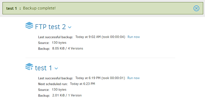

Repro with added stuck in Backup complete status bar is pretty easy too.
I’m actually in 2.1.0.111 now, as I’m leaving 2.1.0.110 stuck for debugging.
Rather than a scheduled job (which at least at GUI won’t do fast schedule,
I supplemented a 6 minute schedule with manual runs. After about 20, got:

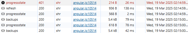

From a log file, the backups have been running, with last run done at 6:35.
Web UI is getting progressstate every 2 seconds. I’m not watching WS.
This is the part that is “stuck”. Since no task is running, this is supposed to be null.
What I recall is that a refresh of the page will reset this value, indicating that the problem is somewhere around updating this value.
The value will be pushed over a websocket when it changes, but I can see that the task list and the poll are not guarded by the same lock, so it is possible that this is a race where the task data is not updated when the notification is sent, but is then changed shortly after the data is sent.
This would cause no new messages to be sent, but the state seen by the FE is incorrect. Fixing it is a bigger problem because this is written in a way that is not really compatible with the ASP.NET way of working. A rewrite of the queue, runner, API and general notification system is needed.
Short term fix is probably to request fresh data periodically, to avoid these long periods of stale data.
