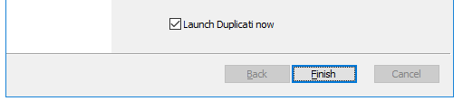

Don’t tell it to do both. If you plan to use service only, you can install without its TrayIcon startup.
You can start read near “If you want to start the server component another way (i.e. by registering the server component as a Windows service), you have 2 options:”, and you could also uncheck:
