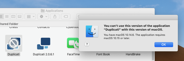

The app has a built-in minimum system requirement of macOS 10.15 (see screenshot). Perhaps this restriction can be removed if Duplicati indeed runs on High Sierra and higher.
Not sure where the number 10.15 comes from, it is not in the Duplicati code, and not in the plist.

I successfully changed the plist file but the app is still crossed out. I wonder where this v10.15 number is hiding.

Ok, some follow up, it turns out I was misreading the version numbers.
The minimum version supported is 10.15 (Catalina), and this is because .NET8 does not support older versions.
You can try to work around it by patching the binary:
vtool -set-build-version macos 14.0 12.0 -replace -output /Applications/Duplicati.app/Contents/MacOS/duplicati
This should update the minimum version of the binary to MacOS 14.0 and SDK 12.0, so it can run.
However, since .NET is not supported on this version, it may not run as expected.
Btw, the latest officially supported .NET version is actually MacOS 13 (Ventura), which is also the latest version that is still supported by Apple.
