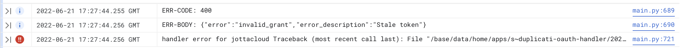

I’m curious: Does everyone have problems like this:
Failed to authorize using the OAuth service: Server error. If the problem persists, try generating a new authid token from: https://duplicati-oauth-handler.appspot.com?type=jottacloud ---> System.Net.WebException: The remote server returned an error: (500) Internal Server Error.
Or does it just work :tm: for some of you as well? I only have a small backup set up myself, but have not seen this issue yet… :thinking:
Pretty much everybody :slight_smile: See the logs above - any longer operation will lead to the token not being refreshed correctly and that operation will fail as well as any other afterward.
When I was pushing backups for about 1TB at 3MB/s (because of the same error I was not able to repair that DB - it takes too much time and it expired every time; unlike repair, upload can be continued from where it stopped and for this particular backup, I did not need history that much).
It crashed like every 12 hours. I had to regenerate the token and replace it in all backup settings. Having 10 of them, that’s why the macro above to replace it in all configs. Native support for that would be cooler though.
I’m getting this error consistently. Should you need more logs or if you want to do a remote session, I’d be more than willing to help out as much as I can.
Not sure, but I think logs from the oauth service are needed to get relevant info, so that is a bit of a challenge. I will try some more to reproduce it locally, maybe with --throttle-upload or something, to make the backup operation slower (or is there any other tricks you can think of?). Token renewing per se seem to work, as even with a small backup it happens every time the backup is run when it is more than one hour since the token stored in oauth service was last refreshed. So I assume the problem is related to backups (or repairs) taking more than one hour, but seems not consistently related to just that one hour refresh either. Tried to time my backup runs to make a token refresh required in the middle of it, but did not get any errors out of that.
I can confirm this. Approx every 12h the token gets invalid.
If it is due to heavy backup operations or sth. else I cannot tell.
I just had an OAUTH token expire in <6 hours:

There is nothing in the logs really. All the jottacloud refresh errors I can see are the same:
It just says “Stale token” indicating that the token has expired for some reason.
More alarmingly, I see some similar errors for the other backends, which could indicate that the refresh token is not persisted after being refreshed, so the old refresh token is re-used, causing a login problem later. If this is the case, anyone affected by it would need to obtain a new auth-token :cry: .
Update: it appears it was a cluster of bad requests in the logs, there are many that are working and no flood of user reports indicates that the service is working as before for non-Jottacloud entries.
I generated a new OAUTH token ~22 hours ago. So far, it’s been working. I’m not sure what changed, but this is the longest one token has lasted. I’ll keep you guys updated when/if this token expires.
Was running a backup for over 24hours without a problem.
I got OAuth error when three dlist and dindex files were uploaded within a minute.
I assume the token gets stale if to many refresh request come in within a defined period.
