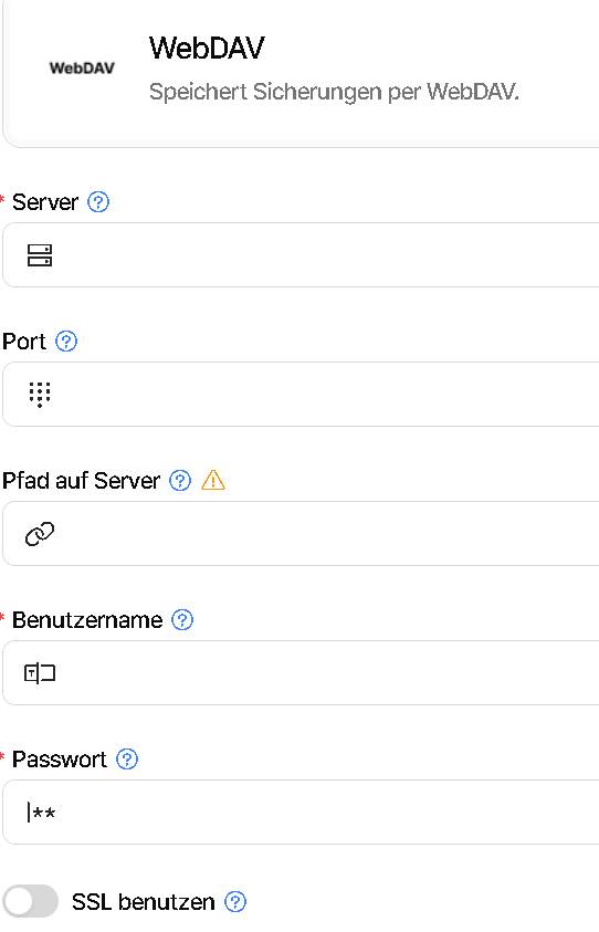

I have 4 jobs on Duplicating runnig. One runs daily, two weekly and one on demand. One of the weekly jobs (the fourth in the list) loses Host Name, Port, Path and User very often (I supose every second time it is running).
Any idea what I can do to do not lose the data?
Version: 2.2.0.2 - 2.2.0.2_beta_2025-11-26 on actual Win 11 (10.0.26200.7623)

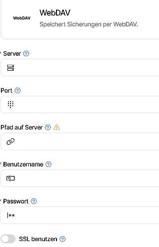

I add the lost data but when I send the job and reedit it there are no data in the fields.

I only use the UI nether the comand line. Browser: actual Firefox. I got an error message like ‘host not found’ or similar. When I edit the job the fields for host name, … were empty. First I could add the host name, … and the job runs. After some weeks (the job juns weekly) I got an error again. For two or three times it helps to edit the job. But when I wrote the post I could not start the job. After editing the job and ‘send’ it and edit job again the data was lost. Only removing the job and import it from file solves the problem.

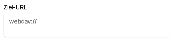

I added a screenshot of the job:
When I show the command line destination is empty:

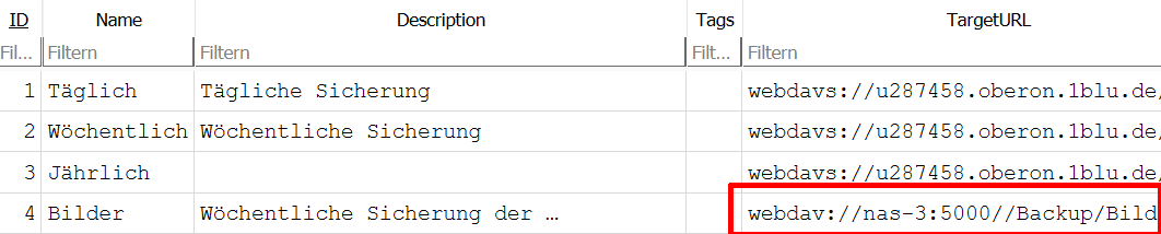

The job configuration is stored in the server database:
There is no history logging unfortunately, but the field you are looking for is in the Backup table and named TargetURL.

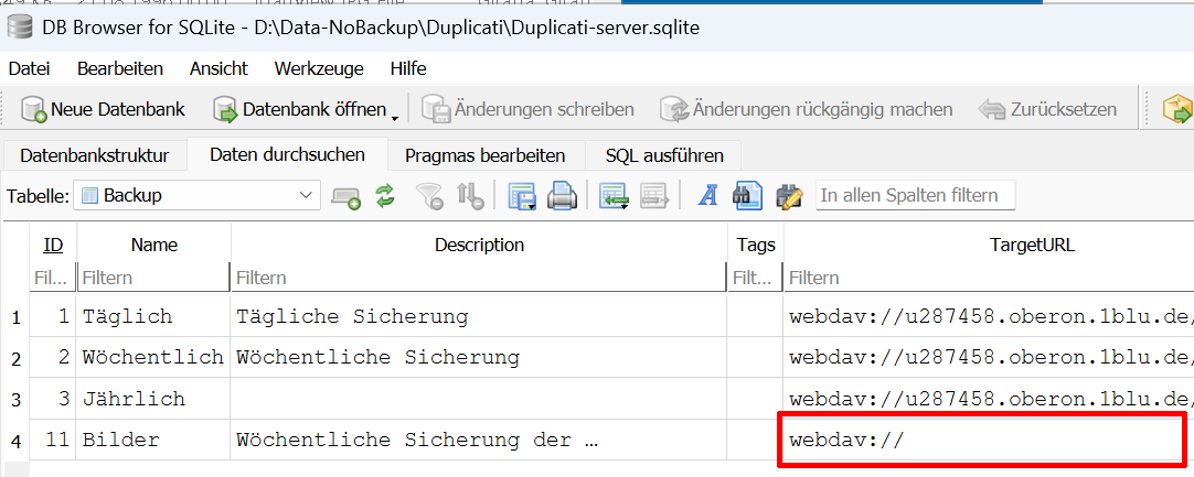

I opened Duplicati-server.sqlite by DB Browser for SQLite and TargetURL is empty:
I found 2 backups of Duplicati-server.sqlite from January 7 and December 3. In both files TargetURL is not empty:

Interesting things happens: This morning I edited the job and added the server data.
Then the job runs without error. I checked Duplicati-Server.sqlite and saw the server data in TargetURL.
After that I edit the job and in the edit page there are no server data. When I open Duplicati-Server.sqlite I see the server data as long as I do not leave the destination page in the edited job.
My explantation: the UI does not read the server data from Duplicati-Server.sqlite but writes it back.
