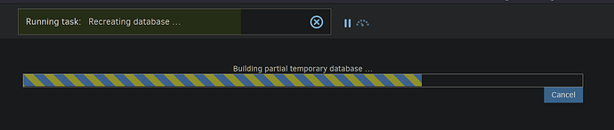

Trying to restore from a backup after a Windows clean install and I am stuck at:
Building partial temporary database …
I cancelled this task before and was able to skip to the next part and restore majority of my files, but I now realize that not everything was restored. Many of my folders are missing a handful of files.

EDIT: Just left this over night for 6+ hours and its still hasn’t progressed past this

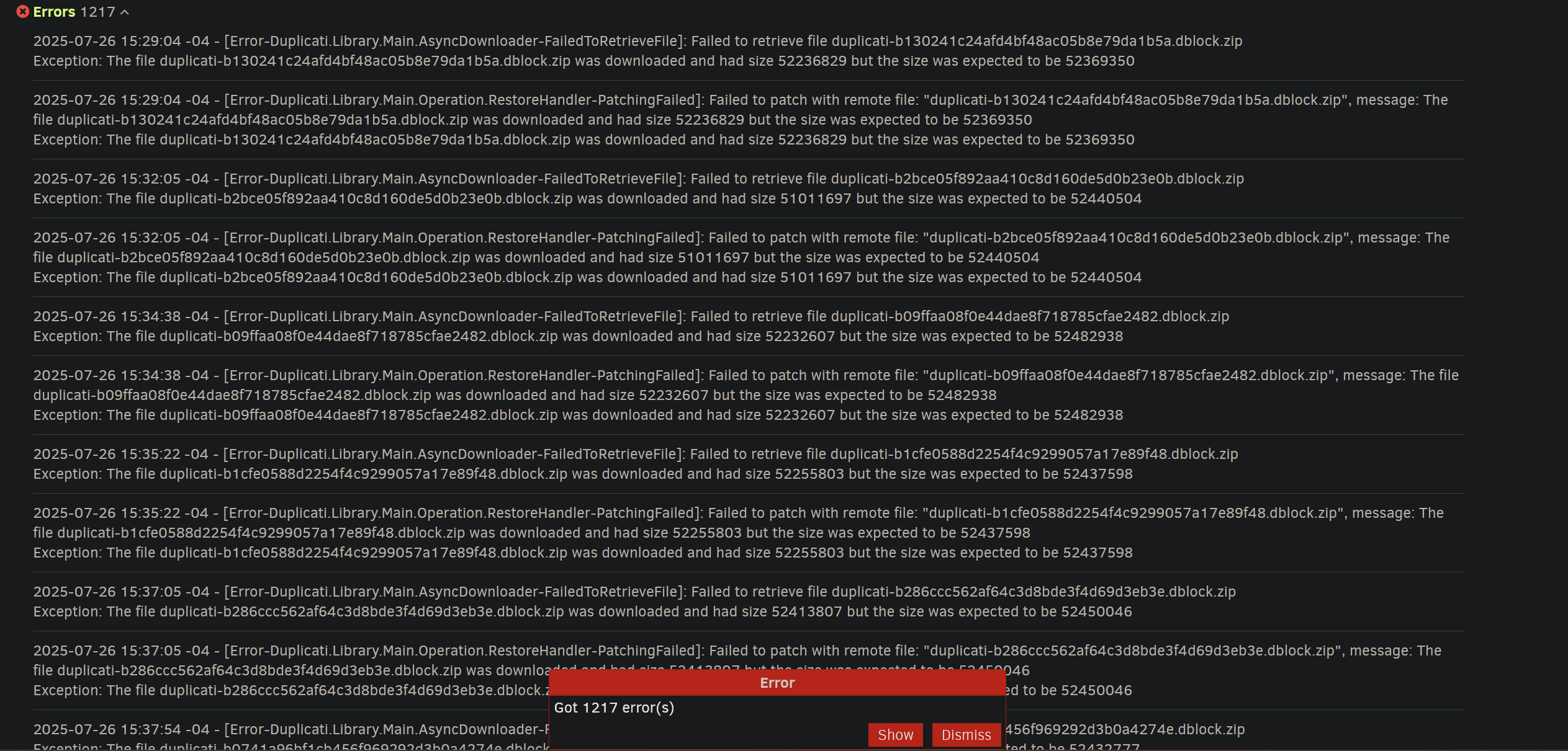

EDIT 2: I cancelled the task so it would move to the next step, and I get this error:
EDIT 3: looks like leaving it overnight and skipping to the next task did restore more of my missing files, but I honestly cant be sure if everything was restored

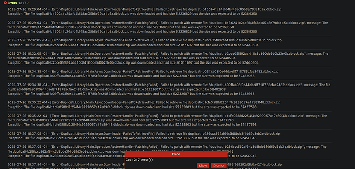

EDIT 4: I let it finish the restore and “verify restored files” and I got the same sha2 errors from before my Windows clean install:

What is this reference to “sha2 errors”? Are they in the EDIT 4 image somewhere?
What I can see is some files that somehow got smaller. Were they always on USB?
You show dblock files. They default to 50 MB and keep the actual data from source.
For restore, this data gets pulled out and put back into the right spots in restore files.
That only works if dblock can be opened. Yours are just .zip files. Can they open?
Basically, just try to open some in Explorer, and don’t worry about the content inside.
The 280 GB backup size might call for 5600 dblock files, but errors shown were less.
This is consistent with having gotten something back. One peril is that a file can look restored by file name being there, but actually partly there, since it’s rebuilt by blocks.

hmm I guess i misread. I thought that this recent log was showing the sha2 error. I think I was mistaken and this “dblock smaller” was the error I was getting pre-clean install

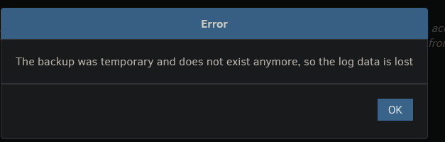

I cant seem to pull the logs anymore unless if I redo the restore:

I meant check a few that Duplicati errored on, e.g. on your image.

The error messages here say that the remote files (the ones stored on the 2TB HDD) have incorrect lengths. The size differences look quite strange. The first entry is around 130kb to short, and the next file is more than 1mb short. (Note that each defective file is listed twice in the log).
Have you tried specifically to open the file duplicati-b130241c24afd4bf48ac05b8e79da1 b5a.dblock.zip and verify that it is indeed not damaged? Can you try to manually copy the file from the 2TB HDD to another disk and check what size the resulting file has?
If you can verify that the files are not damaged (or don’t care) then you can --skip-file-hash-checks which will avoid the check to see if the files are actually correct, and just use them “as-is”. Note that this may cause other errors to appear if the files are indeed defective.
It should not take that long, but we have discovered an issue that causes incorrect index files to be created during some operations. When this happens, the database recreate takes significantly longer. It essentially grabs the dblock files at random and scans them to find the information that is needed. This means it needs to process the entire 280GB before the database is recovered.

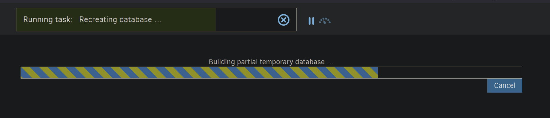

seems to just get stuck at:
(still)
