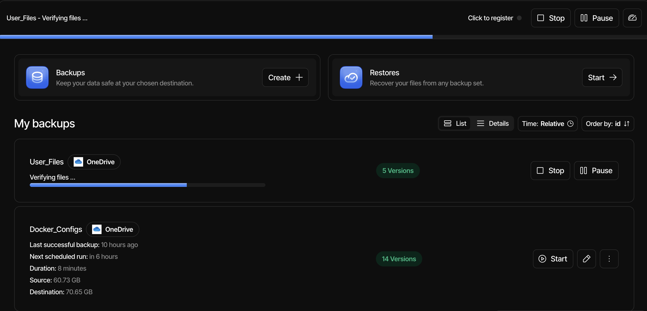

My backup jobs to OneDrive intermittently hang during the post-backup compact phase (UI shows “Deleting unwanted files”). It’s not tied to a specific job — different jobs hit it at different times — which suggests a general OneDrive backend issue rather than a job-specific problem. The main upload completes, then the job stalls indefinitely and must be stopped manually. Profiling logs show it hangs on a download of a large dblock that starts but never completes.

  • Backup upload phase completes normally.
  • Job then stalls during the compact/cleanup phase.
  • Container CPU drops to ~0.08% — the process is idle/waiting, not CPU-bound.

  • Profiling log shows: Backend event: Get - Started: duplicati-....dblock.zip.aes (249.830 MiB) with no corresponding “Get - Completed” and no error. Smaller dindex files (~16 KiB) in the same run complete in ~1s. The large download simply never returns.
  • Requires manual stop; on restart it goes straight back to the same phase.
  • Affects different jobs at different times, not one specific job/dataset.
  • I have to stop/abort the job or restart the docker container to cancel the hung job.
