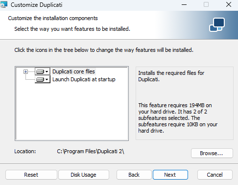

This is a very special case in Windows Setup (tested on Windows 11 OS), just reporting it for completeness:
If an additional drive is mounted when starting the setup exe but unmounted before actual installation starts, setup aborts with an error. Note that the additional drive is not selected as installation location. Step-by-step instructions:
  1. Mount a drive (in my case, mounted to A:\)
  2. Start setup (tested for duplicati-2.1.0.5_stable_2025-03-04-win-x64-gui.msi)
  3. Check location in Customize Duplicati step (not pointing to the mounted drive but to permanent drive C:\)
  4. Unmount the drive (in my case, the previously mounted drive A:\)

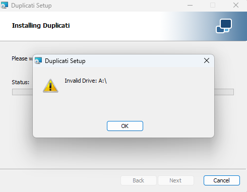

  5. Continue setup to Installing Duplicati step → Error message is raised

@redusr Thanks for reporting the bug.
I was able to reproduce it and with msiexec /i duplicati-2.1.0.5_stable_2025-03-04-win-x64-gui.msi /L*v install.log I was able to collect the extended logs of the MSI installer.
Right in the beginning of the installer there is an event:
PROPERTY CHANGE: Adding ROOTDRIVE property. Its value is 'B:\'.
It hit me to test mapping a letter further down the alphabet than C:\ so I created a T:\ mapped and did the same test, which installed without error, even disconnecting T:\ in the same stage as the test case, and the log then shows:
PROPERTY CHANGE: Adding ROOTDRIVE property. Its value is 'C:\'.
So it seems to be a behavior of the MSI installer to select the ROOTDRIVE as the lowest alphabetical drive. I am not certain we can prevent that, but we can investigate. In any event its a non critical edge case, just interesting.
On the other part of the question I am not certain, I hope someone else can clarify.
Thanks for testing and confirming! I agree that a relatively uncommon setup is affected by the bug, thus probably not that urgent to fix.
