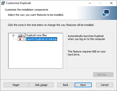

Duplicati should be installed as a service. Therefore, it must not start on login. So, it needs to be removed. Furthermore, it should be installed in a different path. And at the end of the installation, the checkbox for “Start Duplicati now” must be unchecked.
That’s the requirement. And I’d like to automate this if possible.

I assume you mean the below, but I don’t like its “startup” wording
because it’s too suggestive of system startup. It’s actually at login.

This is the other usual thing one changes to avoid the default of a plain TrayIcon.

https://github.com/duplicati/duplicati/commits/master/ReleaseBuilder/Resources/Windows/TrayIcon/Duplicati.wxs
will show installer change history. In 2019 era, a second developer volunteer did:
Add parameter to Wix installer that will install only the core feature #3893
This new option will only install the Core feature and will not auto start Duplicati:
msiexec /i duplicati.msi FORSERVICE = “true”
