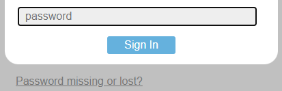

But when I type the password of the interface web of duplicati since the tray, impossible to access to GUI duplicati…

No. Look again at the image from the video. Video shows install. You didn’t type that.
I don’t think INSTALL versus install matters. You can see that I typed it in lowercase.
Not really. I warned you of this before, but there were bigger problems to work on first.
Duplicati Access Password is the documentation. It’s also linked on the password page:
Example change with a different context is a Windows service example for usual setup.
You used --portable-mode which puts the databases in data folder below the install.
C:\Program Files\Duplicati 2>Duplicati.CommandLine.ServerUtil change-password --server-datafolder "C:\Program Files\Duplicati 2\data"

You just have to cd to the install folder and type Duplicati.CommandLine.ServerUtil change-password --server-datafolder "C:\Program Files\Duplicati 2\data" after starting the service. This will change the password as shown in the post that I just made.
You don’t need to be that much of a geek, but it’s nice to know there’s one and where it is.
The local database describes what it does. The Database screen will let you administer it, should something go wrong with it, you want to move it, etc. I predicted where you’ll see it, however if you want to check you can just go there and see if it has Duplicati-server.sqlite which technically is the server database, but by default the job databases go in that folder.
You certainly can do that, but it will have some limitations. Bypassing the password is one nice advantage. Clicking on the icon will open a browser tab without a password needed.
