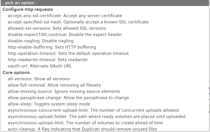

The help for a command does not list all the generic options which one might want to use.
Admittedly this leaves some things to guess or test, but there are an awful lot of options…

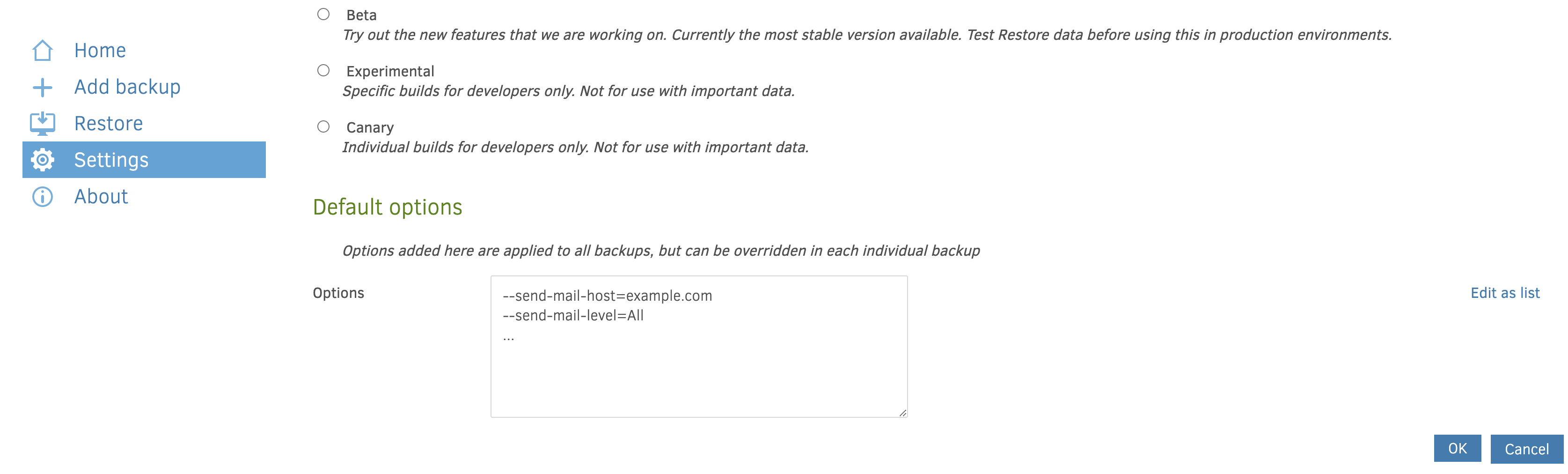

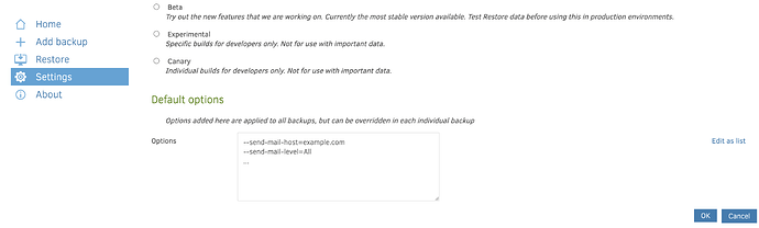

But I can now see that you are running duplicati-server and this does not support passing the --send-mail* arguments as it only accepts options related to hosting the webservice and runner.
You need to instead go into the “Settings” area, and enter these as advanced options. You can click the “Edit as text” to get something where you can copy in the settings:
By setting the options here, they will automatically be applied to all backups, unless you override them on the individual backups.
There is currently no simple way to pre-load the settings database, if that is your goal.
