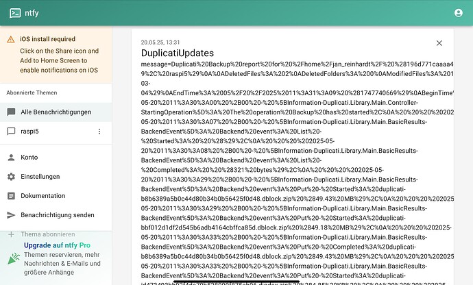

Unfortunately, the form url encoded body of the message is displayed by ntfy.sh like this:
(How) do I change this? Ive read the docs, but there doesn’t seem to be an easy answer. Just changing the above output format to json doesn’t work, Im getting back an error from ntfy.sh then.

Yes, that is the standard format, but it looks like ntfy.sh does not support that.
The only two options are form-encoded and JSON encoded, and it looks like neither works well here.

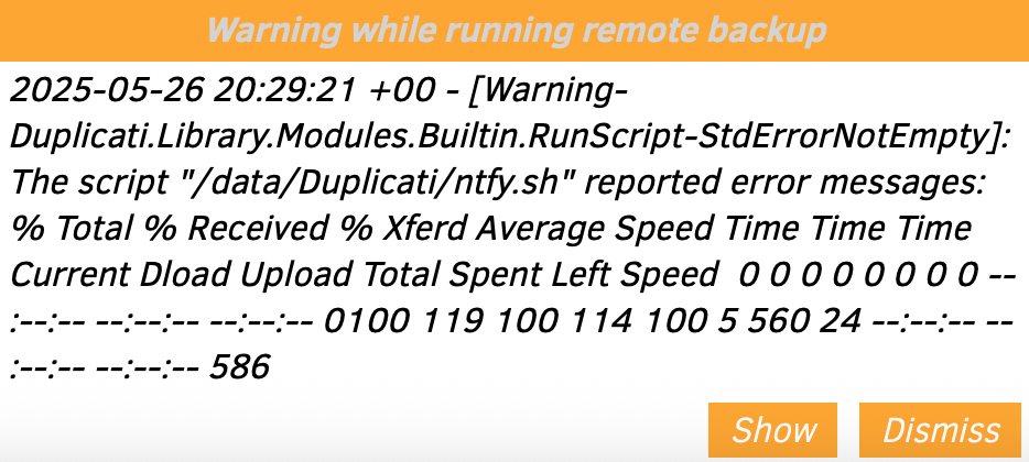

leads to this error message:

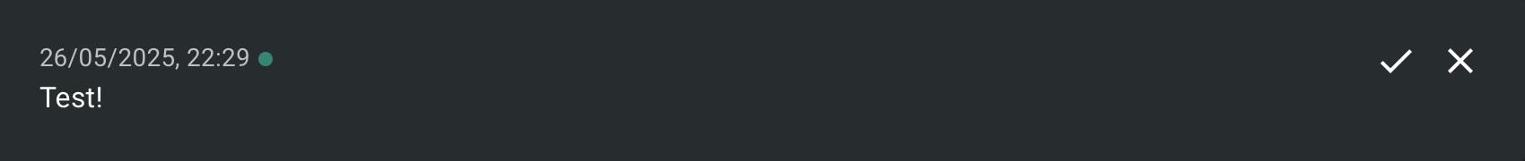

and to this notification on ntfy.sh:
Could you please help some more?

To try to explain some of this (unfortunately not yet all), Duplicati assumes that output on stderr is something like a warning or error from whatever you ran, so passes it on to you.
Unfortunately curl puts its progress message on stderr, so that’s why you get the warning.
