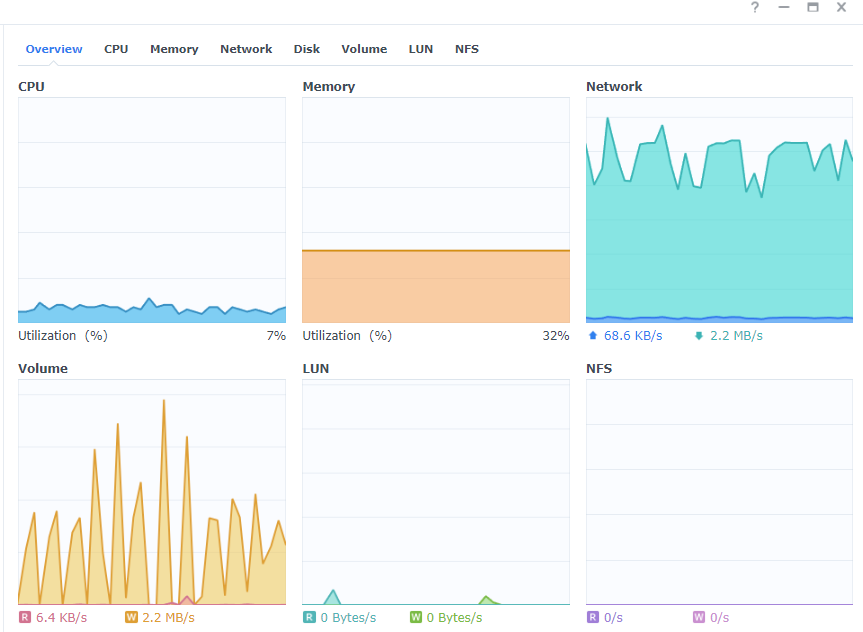

Source IO / upload speed:
(upload is bottleneck)
Target IO/upload:
My upload during backup :
Log after cancelling backup:
