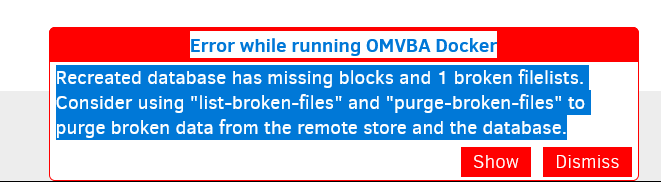

got this error how can i solve it? i don’t find these options

  • Error while running OMVBA Docker
Recreated database has missing blocks and 1 broken filelists. Consider using “list-broken-files” and “purge-broken-files” to purge broken data from the remote store and the database.
ok edited as text and added, seems are not supported
Running commandline entry
Finished!
Backup started at 1/12/2025 10:33:22 PM
The supplied option --list-broken-files is not supported and will be ignored
The supplied option --purge-broken-files is not supported and will be ignored
Checking remote backup …
The operation Backup has failed with error: The database was attempted repaired, but the repair did not complete. This database may be incomplete and the backup process cannot continue. You may delete the local database and attempt to repair it again. => The database was attempted repaired, but the repair did not complete. This database may be incomplete and the backup process cannot continue. You may delete the local database and attempt to repair it again.
They are not backup command options. These are commands themselves.
