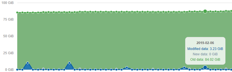

You can also subscribe to Duplicati-Monitoring. The HTTP reports that were received by the service, are visible in a nice looking graph that can be used to find large and small backups.
I second the recommendation for using that Duplicati-Monitoring site. It is fantastic!
Gents, the Duplicati-Monitoring is indeed great, I’ve just checked it out. Kudos.

Duplicati-Monitoring covers me in these situations. I get a daily email report and it starts to warn if a backup hasn’t happened recently (time frame is customizable).
