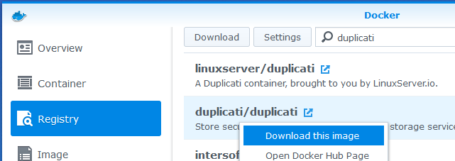

If you set up the docker container properly (all important data is stored outside of the container), then it’s very easy! Go to the Registry and download the latest duplicati image:

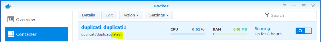

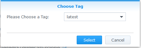

The only complicating factor is if the “tag” is different from what you are currently running:
Once you get the notification that the download is complete, you can Stop the current container, then use the Clear command. This resets the container to the newest downloaded version. Then you just Start the container again.

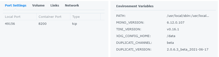

I also upgraded from DSM 6.x to 7.0.1 recently. No issues with Docker for me though, it just continued to work. Can you confirm that it is still set to listen on port 8200? Click Details on your docker container and look here:
@BackupEverything @drwtsn32 Thanks for getting back to me.
The browser is not connecting on port 8200. Yes 8200 is set as the port in the container.

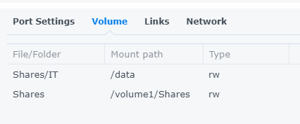

My duplicati config is in /data - did I screw up the config somehow? Does Duplicati not know how to find it?

Your local port is actually 49156. Try going to http://<nas-ip>:49156 in your browser and see if the Duplicati UI shows up.
The 8200 in your screen shot is the port number from the container’s point of view. The local port is how you access it on your NAS, and it maps the traffic to the container at 8200. If you notice my screen shot I use 8200 for both. You can change this mapping if you stop Duplicati container and click the Edit button then go to the Port Settings tab.
If you want the docker files in “Shares/IT” on your NAS, then it’s ok. I leave my /data mapping set to “docker/duplicati” (I think that’s the default). But my preference is for each container to store its settings in the top level “docker” folder.
