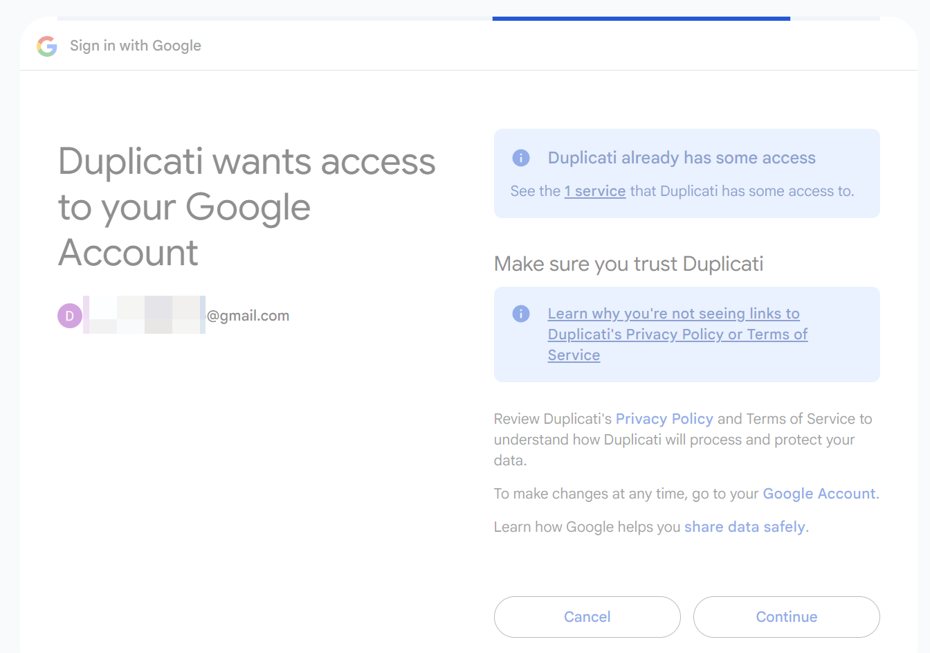

Hi Kenneth,
Thanks. I tried the new OAuth server, but it does not seem to be working.
After I click “Continue” in this screen, I can see the animated progress bar at the top for a while:

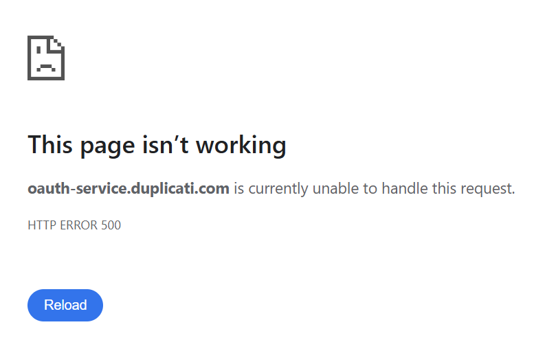

Then eventually I hit error
This page isn’t working
oauth-service.duplicati.com is currently unable to handle this request.
HTTP ERROR 500
Please let me know what I should try next
Thanks !
Gaston
Note that I did receive the Google notification “Duplicati was granted access to your linked Google Account”.
So, it seems to have worked, except that the AuthID was not displayed (therefore I can not use it in the next step).
Best,
Gaston
I can see the problem in the logs. It has somehow lost the connection to the buckets where the tokens are stored. I am working on a fix.
Ok, got the server fixed. Not sure what caused this, but it is connected again.
