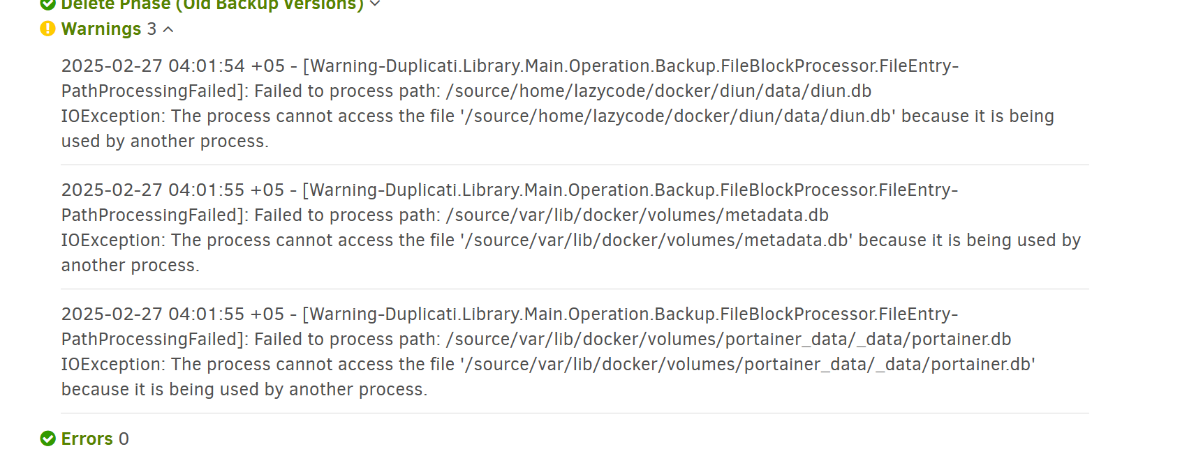

Getting 3 Warning While Backup
Hello Everyone while doing backup recently i always get these error warning is it normal or worrysome…and how can i get rid of them
I’d call it both somewhat normal and somewhat worrisome if you care about that file’s backup.

thankyou i did add to compose but still same
services:
  duplicati:
    image: lscr.io/linuxserver/duplicati:latest
    container_name: duplicati
    environment:
      - PUID=0
      - PGID=0
      - TZ=Asia/Kolkata
      - SETTINGS_ENCRYPTION_KEY=xxxxx
      - CLI_ARGS= #optional
      - DUPLICATI__WEBSERVICE_PASSWORD=xxxxxx
      - DOTNET_SYSTEM_IO_DISABLEFILELOCKING:true
    volumes:
      - ./config:/config
      - /:/source
    ports:
      - 8200:8200
    restart: always

i just cant thankyou enough all was needed was a = sorry for my foolishness and thankyou so so much it worked like a charm
