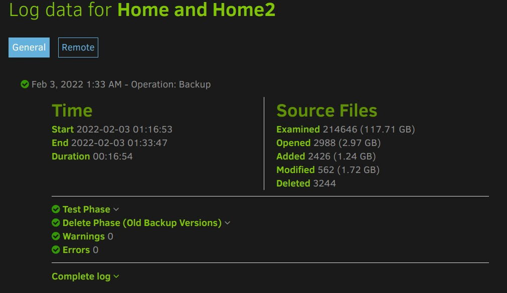

You can also look at the backup job logs to see if a Compact ran (your posted log shows one), because sometimes Compact does the wrong thing, and is more likely to do this if interrupted in middle of things.
History is likely vague, but if issue continues you can set up log-file=<path> log-file-log-level=information which should provide a larger (but not huge – there are huger levels) history giving the actual file names.
