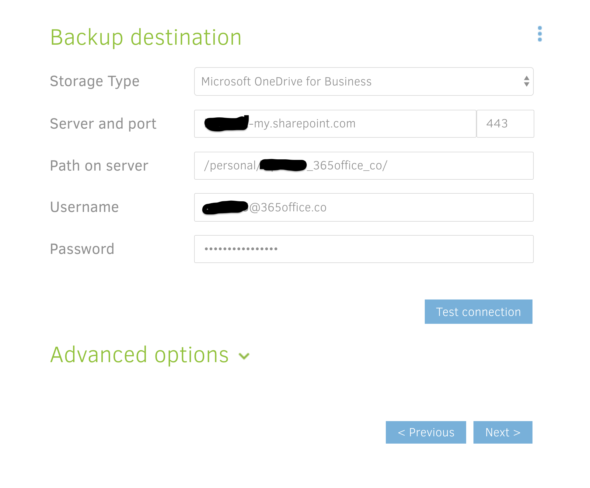

I’m using a QNAP NAS TS-253Be QTS 4.3.6.0776
Duplicati 2.0.4.5
Microsoft OneDrive For Business 5TB
I’ve followed some instructions from this website and QNAP’s Forum. As far as I can tell I’m doing everything that has been suggested. At (2) Destination the connection test returns the message “Connection Works!”.
This is how I’ve set up the destination:
Note:In “Path on Server” I’ve tried /personal/name_domain_com/Files/QNAP, /personal/name_domain_com/Files/QNAP/, and /personal/name_domain_com/Files/, and /personal/name_domain_com/ … none of them work.
This is what is returned after “Verifying Backend Data” is run (its the same for any path I try) …
Is this an issue others have run into?
EDIT: FOR FULL SOLUTION PLEASE READ ENTIRE THREAD.
using /personal/name_domain_com/Documents/ and not /personal/name_domain_com/Files worked … finally!! Its working
