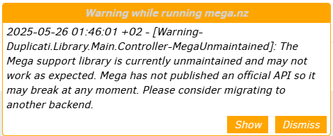

Since I have a backup job on Mega, I receive the log messages:
…[Warning-Duplicati.Library.Main.Controller-MegaUnmaintained]…

Where? Yellow popup? Default job log? Log file? Console output from a command line?
Your attempt to configure console is for command line. A log-file has similar options.
Unfortunately I’m wondering if you mean a yellow warning popup, Show log, and job log.
That’s a more annoying situation that the new feature (if I understand it) is meant to help.
If you mean console or log file output, then filters similar to what you have show will work.
I meant this warning:
