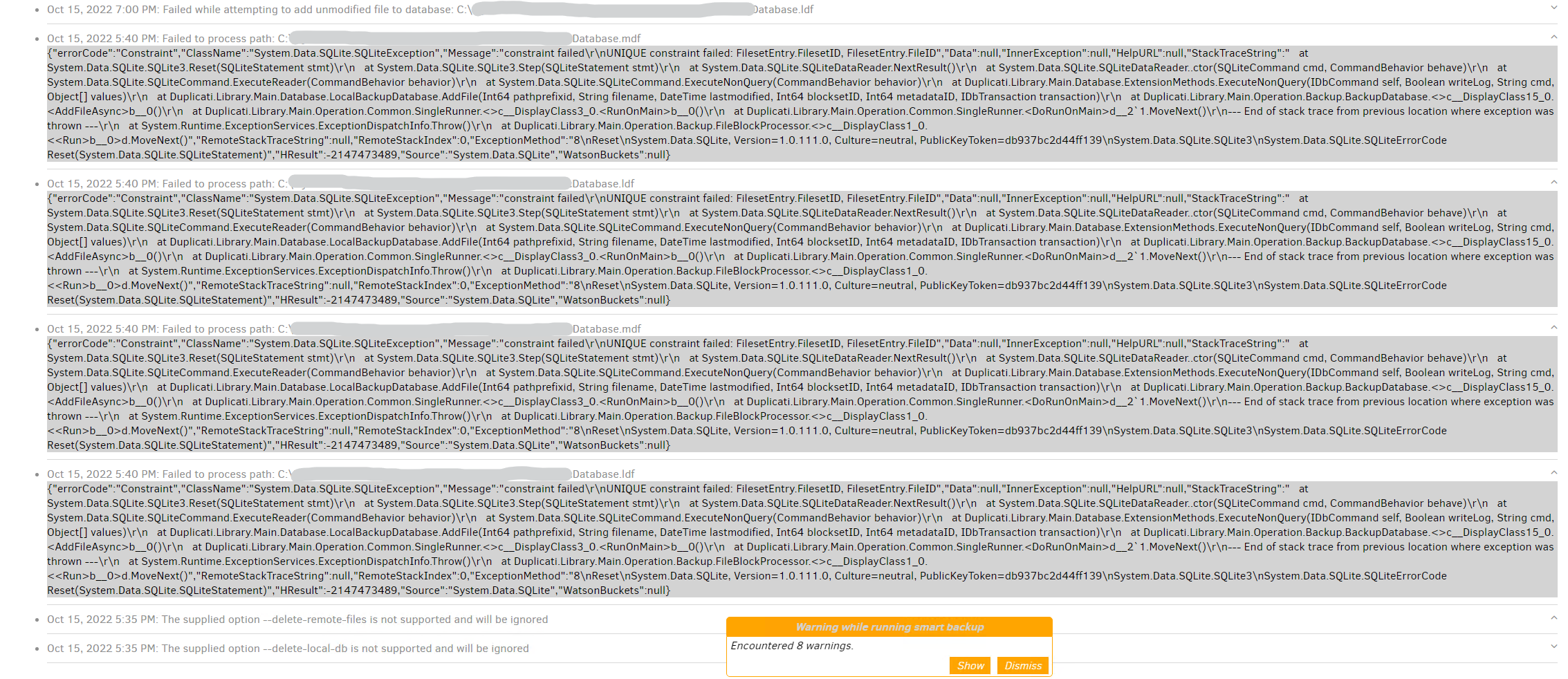

This is all i got from About > Show Log > Live > Warning logs

oh my bad, didn’t realize we can expand the warning message…
Warning
{“errorCode”:“Constraint”,“ClassName”:“System.Data.SQLite.SQLiteException”,“Message”:“constraint failed\r\nUNIQUE constraint failed: FilesetEntry.FilesetID, FilesetEntry.FileID”,“Data”:null,“InnerException”:null,“HelpURL”:null,“StackTraceString”:" at System.Data.SQLite.SQLite3.Reset(SQLiteStatement stmt)\r\n at System.Data.SQLite.SQLite3.Step(SQLiteStatement stmt)\r\n at System.Data.SQLite.SQLiteDataReader.NextResult()\r\n at System.Data.SQLite.SQLiteDataReader…ctor(SQLiteCommand cmd, CommandBehavior behave)\r\n at System.Data.SQLite.SQLiteCommand.ExecuteReader(CommandBehavior behavior)\r\n at System.Data.SQLite.SQLiteCommand.ExecuteNonQuery(CommandBehavior behavior)\r\n at Duplicati.Library.Main.Database.ExtensionMethods.ExecuteNonQuery(IDbCommand self, Boolean writeLog, String cmd, Object[] values)\r\n at Duplicati.Library.Main.Database.LocalBackupDatabase.AddFile(Int64 pathprefixid, String filename, DateTime lastmodified, Int64 blocksetID, Int64 metadataID, IDbTransaction transaction)\r\n at Duplicati.Library.Main.Operation.Backup.BackupDatabase.<>c__DisplayClass15_0.b__0()\r\n at Duplicati.Library.Main.Operation.Common.SingleRunner.<>c__DisplayClass3_0.b__0()\r\n at Duplicati.Library.Main.Operation.Common.SingleRunner.d__2`1.MoveNext()\r\n— End of stack trace from previous location where exception was thrown —\r\n at System.Runtime.ExceptionServices.ExceptionDispatchInfo.Throw()\r\n at Duplicati.Library.Main.Operation.Backup.FileBlockProcessor.<>c__DisplayClass1_0.<b__0>d.MoveNext()",“RemoteStackTraceString”:null,“RemoteStackIndex”:0,“ExceptionMethod”:“8\nReset\nSystem.Data.SQLite, Version=1.0.111.0, Culture=neutral, PublicKeyToken=db937bc2d44ff139\nSystem.Data.SQLite.SQLite3\nSystem.Data.SQLite.SQLiteErrorCode Reset(System.Data.SQLite.SQLiteStatement)”,“HResult”:-2147473489,“Source”:“System.Data.SQLite”,“WatsonBuckets”:null}

all the same. hmm…
This is definitely not normal.
