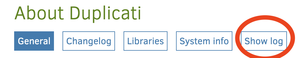

Can you try to use the UI, then click “About”, “Show log” (the button at the top, to the right):
This should show the same error message, but if you click it, it will expand and show some context. If you can copy-and-paste the entire message, then I can perhaps diagnose it a bit further.

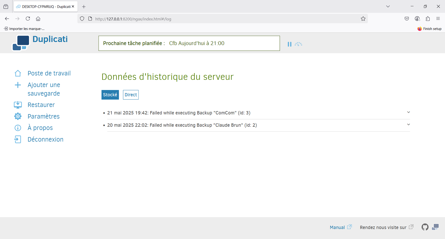

Hello @kenkendk
This is a part of the problem…

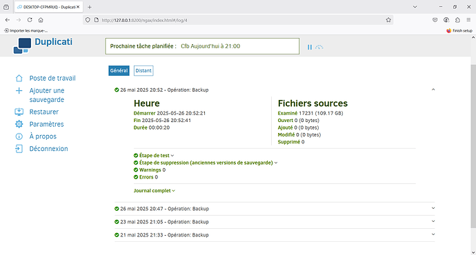

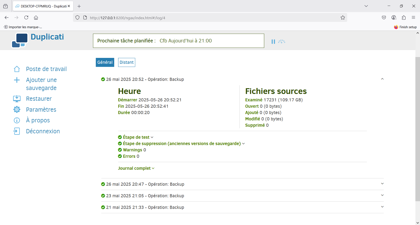

I have a backup name “Commun”
When I start this backup manually with “start now” I have this message error :
2025-05-26 20:52:41 +02 - [Warning-Duplicati.Library.Modules.Builtin.ReportHelper-ReportSubmitError]: Échec de l'envoi du message: System.NullReferenceException: Object reference not set to an instance of an object. NullReferenceException: Object reference not set to an instance of an object.
Under log of the backup : no problem…

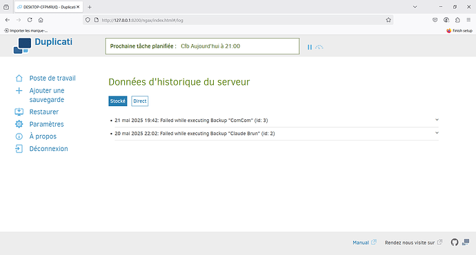

And in to the logs “about” :
I have not Email or alert since this backup
