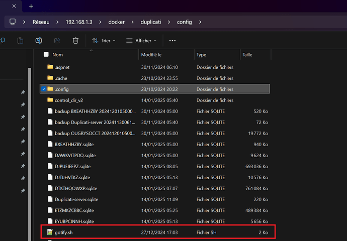

I put my script “gotify.sh” inside the config folder

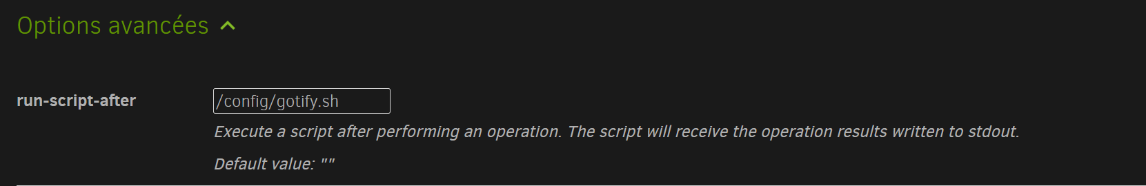

In the settings add to my backup, I indicate the path as follows:
I have made the script executable with a chmod a+x, and at the level of rights it belongs to my user that I indicate in the compose 1000:100.

I have the impression that he cannot find the file. sh that I ask, probably a path problem but I don’t understand which because /config/gotify.sh should be the right one.

You have touched an interesting point, I had errors when i launch the script, infact originally I had created it on my windows client with my notepad, then I put it in my /config folder with my smb share, and I made it executable in CLI.
I deleted it, then created and edited everything in CLI with nano, and now it works perfectly!
