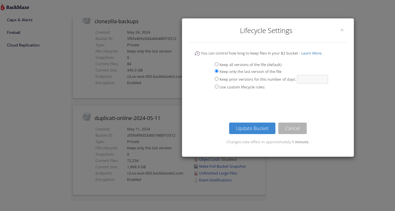

How many versions do you have Backblaze B2 keep? This setting would be on Options screen.

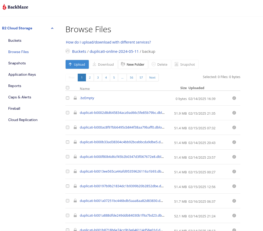

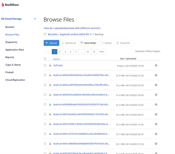

There are files stored in backblaze:

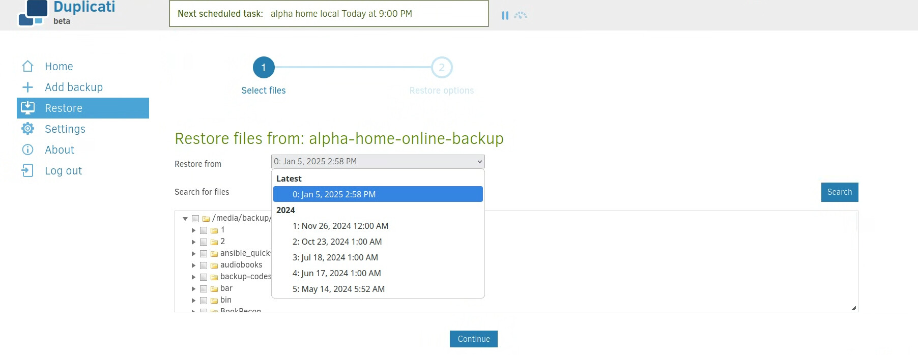

However, the files that those blocks contain are not showing up if I attempt a restore. In other words, I see neither a set 0: or a set 1: or anything else (see below for an example).
Prior to me running the purge command there was a set 0: in the list pictured above. I had just done a fresh initial backup prior to running the purge command. I did a fresh backup (i.e., deleting the backup config and the files in the folder in the B2 bucket where they were going) after running into this on an older backup set with multiple versions/filesets in that dropdown pictured. The prior backup did not error and completed normally–I was purging to save space in B2 after rearranging some things.

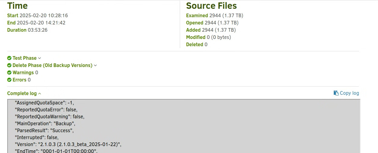

I’ll provide a bit more info here. Hopefully, it’ll be of some help. The backblaze bucket is set to only retain one version of the file:
That being said, I have another backup that’s been running successfully to another folder in the same bucket–but I haven’t tried to purge anything from that one:

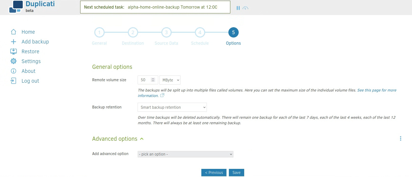

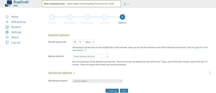

I’m using ‘smart backup retention’ in the options for both backups:

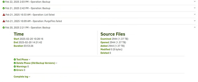

Finally, it spat this out (I have it configured to email me with output) when I attempted to list the files in the backup that’s not showing the files.
Filesets: []
MainOperation: List
ParsedResult: Success
Interrupted: False
Fatal: False
Version: 2.1.0.3 (2.1.0.3_beta_2025-01-22)
EndTime: 2/23/2025 9:27:18 PM (1740364038)
BeginTime: 2/23/2025 9:27:18 PM (1740364038)
Duration: 00:00:00.0537972
MessagesActualLength: 1
WarningsActualLength: 0
ErrorsActualLength: 0
LimitedMessages: [
    2025-02-23 21:27:18 -05 - [Information-Duplicati.Library.Main.Controller-StartingOperation]: The operation List has started
LimitedWarnings: []
LimitedErrors: []
Let me know if there’s anything else I can dig up about this.

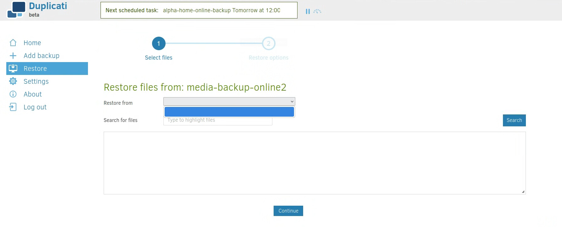

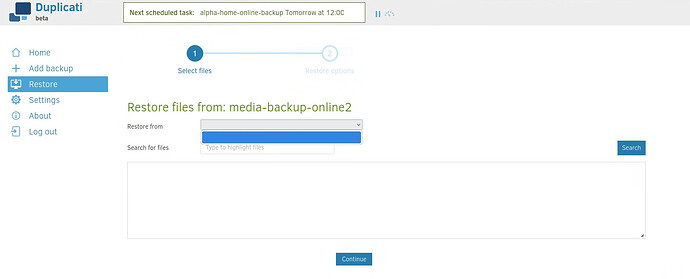

I don’t like seeing that empty space in the Restore version dropdown.

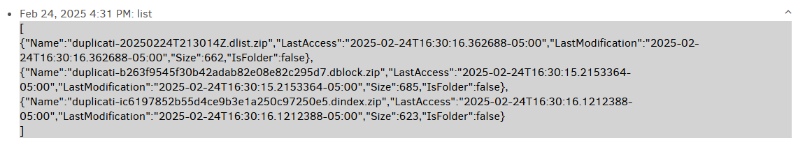

Did the list * command itself show files? Here’s mine, from Commandline:
Running commandline entry
Finished!
Listing contents 0 (2/24/2025 4:30:14 PM):
C:\backup source\A.txt (1 bytes)
Return code: 0

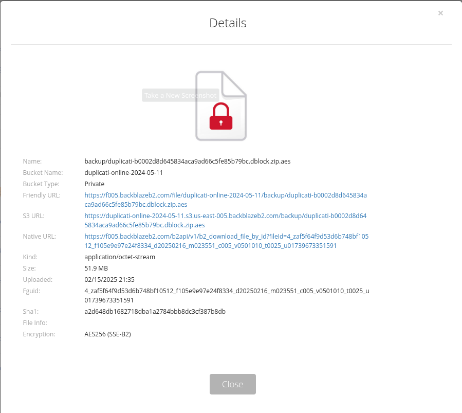

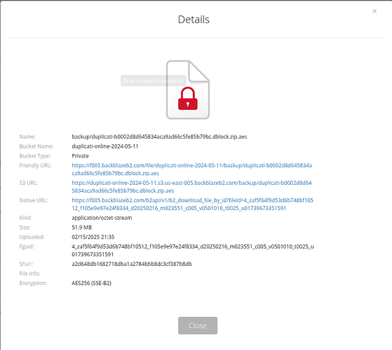

I’ve been able to confirm that at least the first one b0002d8d645834aca9ad66c5fe85b79bc.dblock.zip.aes is present in the folder in the B2 bucket.
Could you give me the syntax of the list * command you’re using from the command line? I’m just getting over a cold and am not thinking totally straight.

Here’s a sample of other dblock files in the folder in the b2 bucket if it helps:
duplicati-b0002d8d645834aca9ad66c5fe85b79bc.dblock.zip.aes
duplicati-b000ac8f97bb6495cb844f38aa79baff0.dblock.zip.aes
duplicati-b000b33ad38304c4bb92bcebbcda9dbe5.dblock.zip.aes
duplicati-b000f80b6d6cf45b2b0347d3f067672e8.dblock.zip.aes
duplicati-b0013ee565ca44afd95359626116a1b93.dblock.zip.aes
duplicati-b00197b9b21834dc1b9399b20b2852dbe.dblock.zip.aes
duplicati-b001a07251bc446bdb5aaa8aa82d83830.dblock.zip.aes
duplicati-b001a888dfde249ddb84030b1f9a7bd23.dblock.zip.aes
duplicati-b001b8718b6e74cc0b3e646114d58e01d.dblock.zip.aes
duplicati-b001bb59d778845cfaaebce0470b1a923.dblock.zip.aes
duplicati-b001bf253ce604847b827911c0901d29a.dblock.zip.aes
duplicati-b0020ab5d7af547868b5a7f0b50942fdb.dblock.zip.aes
duplicati-b002317456a794e4aab7dbe3975080176.dblock.zip.aes
duplicati-b002677bcb32044acaca62d26001945d9.dblock.zip.aes
duplicati-b0028905bce5b4e5a9cb267cc129ee8da.dblock.zip.aes
duplicati-b002a3912d1334cc7997d418afcfc619f.dblock.zip.aes
duplicati-b002bb3ea55034d049531ee7144c5b19c.dblock.zip.aes
duplicati-b002c6c31c1804dd3937a16146e48db09.dblock.zip.aes
duplicati-b002edd13b3eb41eea21e1598880a461c.dblock.zip.aes
duplicati-b002fb89b8f98468984411e29346db780.dblock.zip.aes
duplicati-b002fe62af47247189c4809b8b18afb8c.dblock.zip.aes
duplicati-b0030b42bc43f4edcb5622f41e007de4e.dblock.zip.aes
duplicati-b00324955a71f47638ecc833845a0b2bb.dblock.zip.aes
duplicati-b003b4d46bc214cdda8a6a2f31d6334d6.dblock.zip.aes
duplicati-b003fc4999a5141c4b5866413e13506ca.dblock.zip.aes

Given the lack of Restore versions, I’m more interested in presence or absence of dlist files.
Please check the Backblaze GUI and Duplicati job → Show log → Remote. If none, that’s bad.

Let me mount the b2 bucket and see about the dlist files… one sec… Looks like they are absent from the b2 folder:
klucas@alpha:~/iso/b2/duplicati-online-2024-05-11/backup$ ls *dlist*
ls: cannot access '*dlist*': No such file or directory
There also appear to be no dlist files in Duplicati–>Job–>Show log–>remote.
I guess that’s bad then.

Yes. It confirms the bad news suggested by blank Restore dropdown.
Despite a prevention of deleting last (and only) version, it looks gone.

Regardless, I tested a theory that maybe things were bad before purge. I deleted all versions:
Finished!
  Listing remote folder ...
  Deleting file duplicati-20250224T213014Z.dlist.zip  (662 bytes) ...
  Deleting file duplicati-b263f9545f30b42adab82e08e82c295d7.dblock.zip  (685 bytes) ...
  Deleting file duplicati-ic6197852b55d4ce9b3e1a250c97250e5.dindex.zip  (623 bytes) ...

If you still have the old job and database, I suppose you could see if job → Show log → Remote mentions Delete of that last dlist file. If seen, the context of it might say what was happening.
Here’s my last dlist file delete, but (also visible from Commandline GUI), it also took dblock and dindex too, basically emptying destination. It also did a good job of emptying Restore dropdown.
Feb 25, 2025 11:56 AM: delete duplicati-ic6197852b55d4ce9b3e1a250c97250e5.dindex.zip
Feb 25, 2025 11:56 AM: delete duplicati-b263f9545f30b42adab82e08e82c295d7.dblock.zip
Feb 25, 2025 11:56 AM: delete duplicati-20250224T213014Z.dlist.zip
Feb 25, 2025 11:56 AM: list
Maybe the developer will have some ideas on your case.

Tried to load the full log for the time that the purge command was run from job–>Show log–>Remote but it was 56739 lines and doesn’t seem to fit here in a forum post. Regardless, there’s no reference to dlist files in it. Here’s a sample:
{"Name":".bzEmpty","LastAccess":"2025-02-14T21:39:12.656Z","LastModification":"2025-02-14T21:39:12.656Z","Size":0,"IsFolder":false},
{"Name":"duplicati-b0002d8d645834aca9ad66c5fe85b79bc.dblock.zip.aes","LastAccess":"2025-02-16T02:35:51.591Z","LastModification":"2025-02-16T02:35:51.591Z","Size":51931053,"IsFolder":false},
{"Name":"duplicati-b000ac8f97bb6495cb844f38aa79baff0.dblock.zip.aes","LastAccess":"2025-02-15T12:32:19.334Z","LastModification":"2025-02-15T12:32:19.334Z","Size":51388861,"IsFolder":false},
{"Name":"duplicati-b000b33ad38304c4bb92bcebbcda9dbe5.dblock.zip.aes","LastAccess":"2025-02-15T01:43:32.558Z","LastModification":"2025-02-15T01:43:32.558Z","Size":51388861,"IsFolder":false},
{"Name":"duplicati-b000f80b6d6cf45b2b0347d3f067672e8.dblock.zip.aes","LastAccess":"2025-02-15T04:57:46.092Z","LastModification":"2025-02-15T04:57:46.092Z","Size":51388861,"IsFolder":false},
{"Name":"duplicati-b0013ee565ca44afd95359626116a1b93.dblock.zip.aes","LastAccess":"2025-02-15T05:27:56.946Z","LastModification":"2025-02-15T05:27:56.946Z","Size":51388861,"IsFolder":false},
{"Name":"duplicati-b00197b9b21834dc1b9399b20b2852dbe.dblock.zip.aes","LastAccess":"2025-02-15T17:56:36.116Z","LastModification":"2025-02-15T17:56:36.116Z","Size":51388861,"IsFolder":false},
{"Name":"duplicati-b001a07251bc446bdb5aaa8aa82d83830.dblock.zip.aes","LastAccess":"2025-02-16T11:37:42.028Z","LastModification":"2025-02-16T11:37:42.028Z","Size":51744557,"IsFolder":false},
{"Name":"duplicati-b001a888dfde249ddb84030b1f9a7bd23.dblock.zip.aes","LastAccess":"2025-02-15T02:24:12.872Z","LastModification":"2025-02-15T02:24:12.872Z","Size":52132205,"IsFolder":false},
{"Name":"duplicati-b001b8718b6e74cc0b3e646114d58e01d.dblock.zip.aes","LastAccess":"2025-02-14T23:13:04.939Z","LastModification":"2025-02-14T23:13:04.939Z","Size":51388861,"IsFolder":false},
{"Name":"duplicati-b001bb59d778845cfaaebce0470b1a923.dblock.zip.aes","LastAccess":"2025-02-16T11:06:19.945Z","LastModification":"2025-02-16T11:06:19.945Z","Size":51467405,"IsFolder":false},
{"Name":"duplicati-b001bf253ce604847b827911c0901d29a.dblock.zip.aes","LastAccess":"2025-02-16T11:19:29.944Z","LastModification":"2025-02-16T11:19:29.944Z","Size":51388861,"IsFolder":false},
{"Name":"duplicati-b0020ab5d7af547868b5a7f0b50942fdb.dblock.zip.aes","LastAccess":"2025-02-16T00:24:24.625Z","LastModification":"2025-02-16T00:24:24.625Z","Size":52167453,"IsFolder":false},
{"Name":"duplicati-b002677bcb32044acaca62d26001945d9.dblock.zip.aes","LastAccess":"2025-02-15T17:46:44.712Z","LastModification":"2025-02-15T17:46:44.712Z","Size":51388861,"IsFolder":false},
{"Name":"duplicati-b0028905bce5b4e5a9cb267cc129ee8da.dblock.zip.aes","LastAccess":"2025-02-15T12:51:28.325Z","LastModification":"2025-02-15T12:51:28.325Z","Size":52330845,"IsFolder":false},
{"Name":"duplicati-b002a3912d1334cc7997d418afcfc619f.dblock.zip.aes","LastAccess":"2025-02-16T05:15:52.803Z","LastModification":"2025-02-16T05:15:52.803Z","Size":51388861,"IsFolder":false},
{"Name":"duplicati-b002bb3ea55034d049531ee7144c5b19c.dblock.zip.aes","LastAccess":"2025-02-15T19:41:48.304Z","LastModification":"2025-02-15T19:41:48.304Z","Size":51388861,"IsFolder":false},
 {"Name":"duplicati-iffe57e8363ad4d65aa25c6bab1107400.dindex.zip.aes","LastAccess":"2025-02-14T22:15:51.437Z","LastModification":"2025-02-14T22:15:51.437Z","Size":2621,"IsFolder":false},
    {"Name":"duplicati-iffe773caab6542f2921db296e1372641.dindex.zip.aes","LastAccess":"2025-02-16T04:17:39.472Z","LastModification":"2025-02-16T04:17:39.472Z","Size":2621,"IsFolder":false},
    {"Name":"duplicati-iffecb605a1c341c6b2cc920cf2c23acd.dindex.zip.aes","LastAccess":"2025-02-15T06:51:47.723Z","LastModification":"2025-02-15T06:51:47.723Z","Size":2621,"IsFolder":false},
    {"Name":"duplicati-iffeeb1643ce54236bc667e4bf6763131.dindex.zip.aes","LastAccess":"2025-02-15T20:06:37.448Z","LastModification":"2025-02-15T20:06:37.448Z","Size":2621,"IsFolder":false},
    {"Name":"duplicati-iffeeb20293c647999d03cc83f4c88615.dindex.zip.aes","LastAccess":"2025-02-15T08:02:24.646Z","LastModification":"2025-02-15T08:02:24.646Z","Size":2621,"IsFolder":false},
    {"Name":"duplicati-ifff412edd76e4d1aac2c8d954a7b2b84.dindex.zip.aes","LastAccess":"2025-02-14T22:50:44.416Z","LastModification":"2025-02-14T22:50:44.416Z","Size":2685,"IsFolder":false},
    {"Name":"duplicati-ifff640b5f99a448c802b3c20f67c8a1b.dindex.zip.aes","LastAccess":"2025-02-16T11:21:49.879Z","LastModification":"2025-02-16T11:21:49.879Z","Size":2621,"IsFolder":false},
    {"Name":"duplicati-ifff73a9b29e74bb1ad01eb87076aba79.dindex.zip.aes","LastAccess":"2025-02-15T22:45:53.717Z","LastModification":"2025-02-15T22:45:53.717Z","Size":2685,"IsFolder":false},
    {"Name":"duplicati-ifff7db6763c649a88f05c97c645abcd2.dindex.zip.aes","LastAccess":"2025-02-16T09:59:28.946Z","LastModification":"2025-02-16T09:59:28.946Z","Size":9949,"IsFolder":false},
    {"Name":"duplicati-ifff8e05d4edc496d80d0b10ddacf16c1.dindex.zip.aes","LastAccess":"2025-02-15T20:45:54.439Z","LastModification":"2025-02-15T20:45:54.439Z","Size":2685,"IsFolder":false}
Sure, the previous backup job appears to have completed successfully according to job–>Show log–>General
  "DeletedFiles": 0,
  "DeletedFolders": 0,
  "ModifiedFiles": 0,
  "ExaminedFiles": 2944,
  "OpenedFiles": 2944,
  "AddedFiles": 2944,
  "SizeOfModifiedFiles": 0,
  "SizeOfAddedFiles": 1505390752120,
  "SizeOfExaminedFiles": 1505390752120,
  "SizeOfOpenedFiles": 1505390752120,
  "NotProcessedFiles": 0,
  "AddedFolders": 143,
  "TooLargeFiles": 0,
  "FilesWithError": 0,
  "ModifiedFolders": 0,
  "ModifiedSymlinks": 0,
  "AddedSymlinks": 2,
  "DeletedSymlinks": 0,
  "PartialBackup": false,
  "Dryrun": false,
  "MainOperation": "Backup",
  "CompactResults": null,
  "VacuumResults": null,
  "DeleteResults": {
    "DeletedSetsActualLength": 0,
    "DeletedSets": [],
    "Dryrun": false,
    "MainOperation": "Delete",
    "Interrupted": false,
    "Version": "2.1.0.3 (2.1.0.3_beta_2025-01-22)",
    "EndTime": "2025-02-20T19:21:07.8098673Z",
    "BeginTime": "2025-02-20T19:20:52.364617Z",
    "Duration": "00:00:15.4452503",
    "Errors": null,
      "RemoteCalls": 60,
      "BytesUploaded": 0,
      "BytesDownloaded": 0,
      "FilesUploaded": 0,
      "FilesDownloaded": 0,
      "FilesDeleted": 0,
      "RetryAttempts": 24,
      "UnknownFileSize": 0,
      "UnknownFileCount": 1,
      "KnownFileCount": 56736,
      "KnownFileSize": 1463762808544,
      "BackupListCount": 1,
      "TotalQuotaSpace": 0,
      "FreeQuotaSpace": 0,
      "AssignedQuotaSpace": -1,
      "BeginTime": "2025-02-20T15:28:16.6456474Z",
      "Errors": null
  "RepairResults": null,
  "TestResults": {
    "MainOperation": "Test",
    "VerificationsActualLength": 0,
    "Verifications": [],
    "EndTime": "2025-02-20T19:21:42.4611683Z",
    "BeginTime": "2025-02-20T19:21:42.3998694Z",
    "Duration": "00:00:00.0612989",
    "Errors": null,
      "RemoteCalls": 60,
      "BytesUploaded": 0,
      "FilesUploaded": 0,
      "FilesDeleted": 0,
      "Errors": null
  "EndTime": "2025-02-20T19:21:42.4639831Z",
  "BeginTime": "2025-02-20T15:28:16.645638Z",
  "Duration": "03:53:25.8183451",
  "MessagesActualLength": 226,
    "2025-02-20 10:28:16 -05 - [Information-Duplicati.Library.Main.Controller-StartingOperation]: The operation Backup has started",
    "2025-02-20 10:28:21 -05 - [Information-Duplicati.Library.Main.BasicResults-BackendEvent]: Backend event: List - Started:  ()",
    "2025-02-20 10:28:54 -05 - [Information-Duplicati.Library.Main.BasicResults-BackendEvent]: Backend event: List - Completed:  (55.407 KB)",
    "2025-02-20 10:28:55 -05 - [Information-Duplicati.Library.Main.Operation.Backup.RecreateMissingIndexFiles-RecreateMissingIndexFile]: Re-creating missing index file for duplicati-b062403af61e0492bb3e825c8aa285990.dblock.zip.aes",
    "2025-02-20 10:28:56 -05 - [Information-Duplicati.Library.Main.Operation.Backup.RecreateMissingIndexFiles-RecreateMissingIndexFile]: Re-creating missing index file for duplicati-b3fc66b1568294d00931466b366746f12.dblock.zip.aes",
    "2025-02-20 10:28:56 -05 - [Information-Duplicati.Library.Main.BasicResults-BackendEvent]: Backend event: Put - Started: duplicati-i0377a9fbd8c24f3c82ac7b648cab29d4.dindex.zip.aes (2.560 KB)",
    "2025-02-20 10:28:56 -05 - [Information-Duplicati.Library.Main.BasicResults-BackendEvent]: Backend event: Put - Started: duplicati-i408a3a57daad41af9f3bbb38af718960.dindex.zip.aes (2.560 KB)",
    "2025-02-20 10:40:38 -05 - [Information-Duplicati.Library.Main.BasicResults-BackendEvent]: Backend event: Put - Started: duplicati-b0328d426fbf443ca81fe80dddc0cdf93.dblock.zip.aes (49.009 MB)",
    "2025-02-20 10:40:38 -05 - [Information-Duplicati.Library.Main.BasicResults-BackendEvent]: Backend event: Put - Started: duplicati-b181a2fc469624a559afddd07ec37a686.dblock.zip.aes (49.009 MB)",
    "2025-02-20 10:40:41 -05 - [Information-Duplicati.Library.Main.BasicResults-BackendEvent]: Backend event: Put - Started: duplicati-bfe6de3b48de14561ae03a2fb5c6efddd.dblock.zip.aes (49.008 MB)",
    "2025-02-20 10:40:42 -05 - [Information-Duplicati.Library.Main.BasicResults-BackendEvent]: Backend event: Put - Started: duplicati-b0264c7ff493e48c5b1aeb7ae84d26108.dblock.zip.aes (49.008 MB)",
    "2025-02-20 10:40:45 -05 - [Information-Duplicati.Library.Main.BasicResults-BackendEvent]: Backend event: Put - Started: duplicati-b9bd13601aa114455808c435a643446c4.dblock.zip.aes (49.008 MB)",
    "2025-02-20 10:40:46 -05 - [Information-Duplicati.Library.Main.BasicResults-BackendEvent]: Backend event: Put - Started: duplicati-bee18c66349754d8fad50f90172fae16c.dblock.zip.aes (49.008 MB)",
    "2025-02-20 10:40:48 -05 - [Information-Duplicati.Library.Main.BasicResults-BackendEvent]: Backend event: Put - Started: duplicati-b8648b50765b34e18a4277159af238758.dblock.zip.aes (49.008 MB)",
    "2025-02-20 10:40:49 -05 - [Information-Duplicati.Library.Main.BasicResults-BackendEvent]: Backend event: Put - Started: duplicati-bb103e5e6f9684d21981e195f04024163.dblock.zip.aes (49.008 MB)",
    "2025-02-20 10:41:23 -05 - [Information-Duplicati.Library.Main.BasicResults-BackendEvent]: Backend event: Put - Started: duplicati-b3890451be42c4b779b769db019bd3011.dblock.zip.aes (49.008 MB)",
    "2025-02-20 10:41:23 -05 - [Information-Duplicati.Library.Main.BasicResults-BackendEvent]: Backend event: Put - Started: duplicati-b852428dded534b4b82d51a625064f766.dblock.zip.aes (49.008 MB)",
    "2025-02-20 10:41:35 -05 - [Information-Duplicati.Library.Main.BasicResults-BackendEvent]: Backend event: Put - Started: duplicati-b63e56387b84148a58c9b45d13c69b287.dblock.zip.aes (49.008 MB)",
    "2025-02-20 10:41:35 -05 - [Information-Duplicati.Library.Main.BasicResults-BackendEvent]: Backend event: Put - Started: duplicati-bdd621902daf046d7aeb9e0e824f66fa1.dblock.zip.aes (49.008 MB)",
    "2025-02-20 10:55:47 -05 - [Information-Duplicati.Library.Main.BasicResults-BackendEvent]: Backend event: Put - Started: duplicati-b09a4359223c044ecb241175fd37ae81b.dblock.zip.aes (49.008 MB)"
  "Warnings": [],
  "Errors": [],
    "RemoteCalls": 60,
    "BytesUploaded": 0,
    "FilesUploaded": 0,
    "FilesDeleted": 0,
    "Errors": null
Here’s another view showing the order of what happened:
I think Start time of 2025-02020 10:28:16 in the UTC-5 time zone should match this dlist file:
but I’m not sure how the seemingly complete backup left it as Temporary, if I read code right:
is a worry (is something flaky going to B2?), but the default job log only records 20 entries.
Backblaze B2 normally needs retries occasionally, by design, but 24 is possibly excessive.
You can view other job logs, or set options log-file=<path> log-file-log-level=retry.
Since this is part of your regular routine, maybe it would be seen next time (or maybe not?).
Still unclear to me what happened on that failed purge. Developer ideas welcome, as usual.
