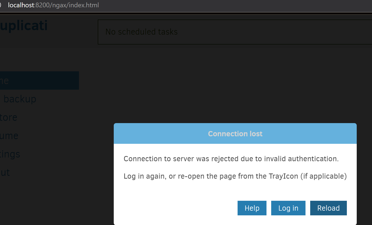

Task Manager shows Duplicati.GUI.TrayIcon as running, but nothing else starting with “dup”. When I terminate that process and then click the Duplicati icon on the desktop, a window fram briefly flashes on the screen, but nothing more happens, except that Task Manager afterwards shows Duplicati.GUI.TrayIcon running again as background process. When I now click the Duplicati icon again, I get the error message attached as screenshot below.
I only want Duplicati to run on a single laptop, taking backups for a single user to a remote location connected via WebDAV. That worked nicely after an out-of-the box installation several months ago and backups still seem to work, just that I can no longer connect to the GUI and manage things.

That sounds like the password is missing. You should be able to get back in with:
  1. Close the browser window
  2. Right click the TrayIcon
  3. Click “Open”
See also this page for a small video an further descriptions:
Thanks a lot, that worked :)!
