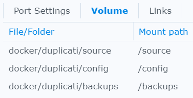

FWIW, set your Volume as:
This is why export/import is unnecessary. Also you have an easy method to backup Docker files via Hyper Backup.

Are you using LinuxServer’s container? I’m using the official Duplicati container and it doesn’t use those 3 mount point mappings, just /data which I map to /volume1/docker/duplicati on the host. It is working well for me!

I put the configs on the NAS (see Volume settings as I posted). Nothing is lost in “Clear” (export the first time if you are unsure). I use this procedure w/all containers.
I am using the image from linuxserver/duplicati.
Pretty much the default features except the Volume settings (shown above) and I use port 8200 > 8200 (not Auto>8200).

yes, so do I… for the Duplicati official docker container, all important data is stored in /data which I map to the host NAS. I do an export/import just to keep all configuration elements (folder mappings, environment vars, etc) - but if that’s not needed then great! I will test next time there is an update to the container.
