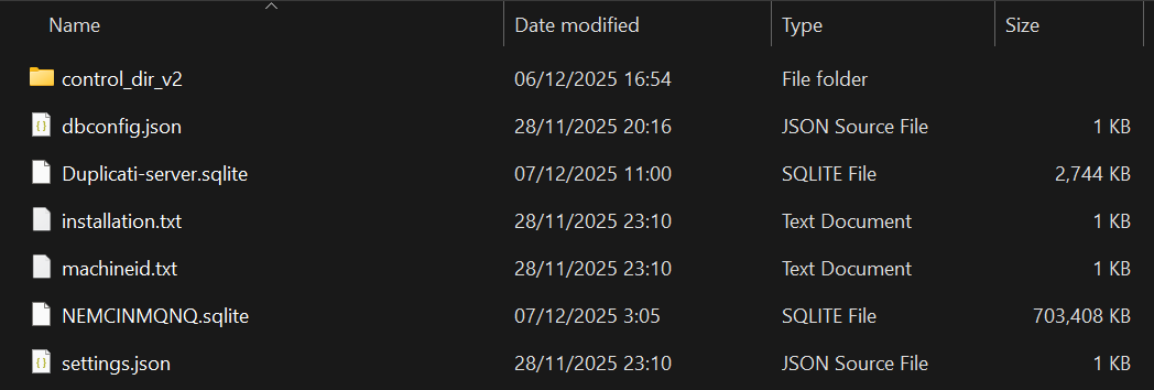

I was able to track down the path where the database is (from the web UI, under my backup job’s context menu → Database → Placement, but I see two .sqlite files

Thanks! And when you mentioned I should test a restore of the database, you were referring to the local database, not the job database, correct?
Is there any potential data loss or job related configuration loss, if the job database is lost?
These are same DB, in Placement, and neither is Server DB.
The local job per-backup DB name is <random-letters>.sqlite.
