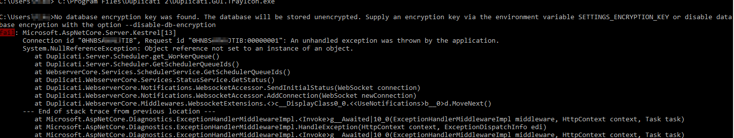

I immediately get an error message of “no database encryption key was found”. The first time I tried it, it immediately went on to report an error, so I assumed this was related, but the second time I tried it, it proceeded to work anyway after this advisory (without the following error). This is the error message I got, which repeated a few times:

The “went on”, to me, meant the Kestrel NullReferenceException, the later message.
I took “advisory” to mean warning, and “following error” to mean the later Kestrel error.
then shows both messages, but I thought image was mostly to show the Kestrel error.
Maybe both of you can clarify which message is meant in unclear cases. I’m confused.
If it’s surprising that the Kestrel error was not always there, if that’s what this says, OK.
My bad for the inclarity of my quoted comment. It looks as if you decoded my meaning correclty, though.
To verify: I was originally describing 2 consecutive attempts to run it from the CLP; both times I got the “encryption” warning, but the first time, I got the terminating error (the part starting with the red-highlighted “FAIL” text), and the second time (with no other changes on my part), I did not get that error, and the attempt went on to work, despite still receiving the “encryption” message.

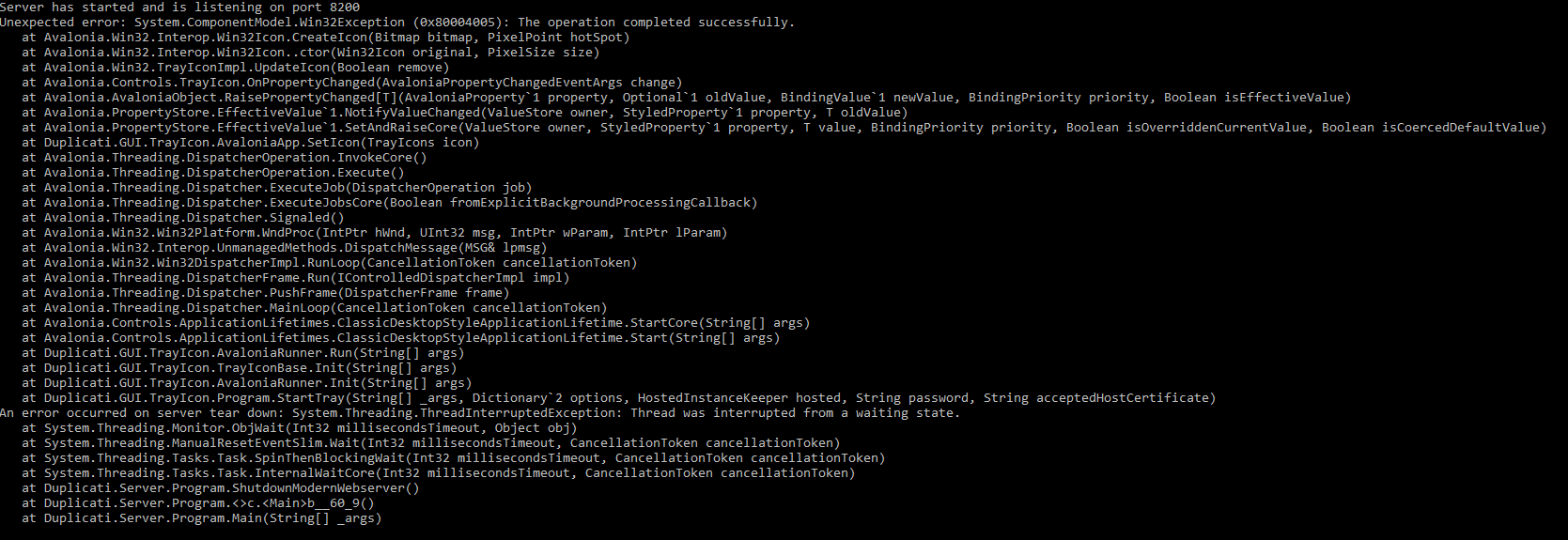

Hey again - the crash when running from CLI eventually happened, here’s a screenshot of the residual result.

I can extract the text:
Unexpected error: System. ComponentModel.Win32Exception (0x80004005): The operation completed successfully.
at Avalonia.Win32.Interop.Win32Icon.CreateIcon(Bitmap bitmap, PixelPoint hotSpot) at Avalonia.Win32.Interop.Win32Icon..ctor(Win32Icon original, PixelSize size)
at Avalonia.Win32.TrayIconImpl.UpdateIcon(Boolean remove)
at Avalonia.Controls.TrayIcon.OnPropertyChanged(AvaloniaPropertyChangedEventArgs change)
at Avalonia.Avalonia0bject.RaisePropertyChanged[T](AvaloniaProperty'1 property, Optional'1 oldValue, BindingValue'1 newValue, BindingPriority priority, Boolean isEffectiveValue)
at Avalonia.PropertyStore.EffectiveValue'1.NotifyValueChanged(ValueStore owner,
at Avalonia.PropertyStore.EffectiveValue'1.SetAndRaiseCore(ValueStore owner, StyledProperty"1 property, at Duplicati.GUI.TrayIcon.AvaloniaApp.SetIcon(TrayIcons icon)
StyledProperty 1 property value, BindingPriority
I am pretty sure this is the problem with not caching the status image. For some reason, the image loader for the TrayIcon would re-load the images every time some update message is sent. In some cases this would exhaust the number of handles available for the process and cause it to crash because it cannot set a new status image.
