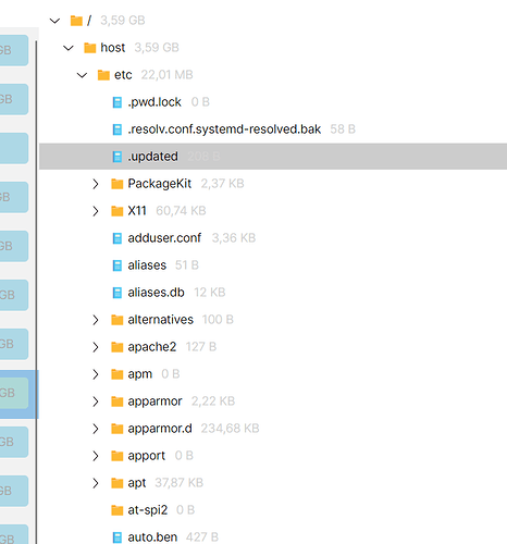

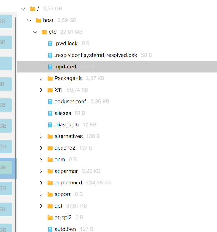

I made some changes to the tool and called it v0.9.0. These changes are included:
  • save and restore expansion state of file trees when switching between different backups
  • add directory and file icons to file tree for proper distinction
  • added option in the context menu to sort file tree items by item size
  • minor UI improvements
Main feature is the option to sort items in the file tree by size to quickly find the big directories/files.
And the file tree looks a bit better now due to new icons:
