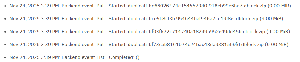

Just reset for fresh backup, started job from new UI. Seems to be working fine:
Since I haven’t found a way to get the problem you see, feel free to look further.

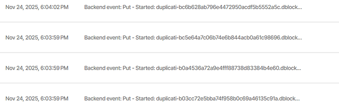

That’s what I see now, with multiple PUTs in succession. Exporting the command line I see

If you’re referring to my post, it’s four starts of simultaneous uploads.
Be sure to read both Started and Completed. No Completed in mine.
That’s four concurrent uploads, which is expected per default setting.
Yes, that’s what I mean. I see 4 PUTs start in a row, before they then complete later. Before I was seeing alternate PUT and COMPLETE, because it was only doing one upload at a time.
