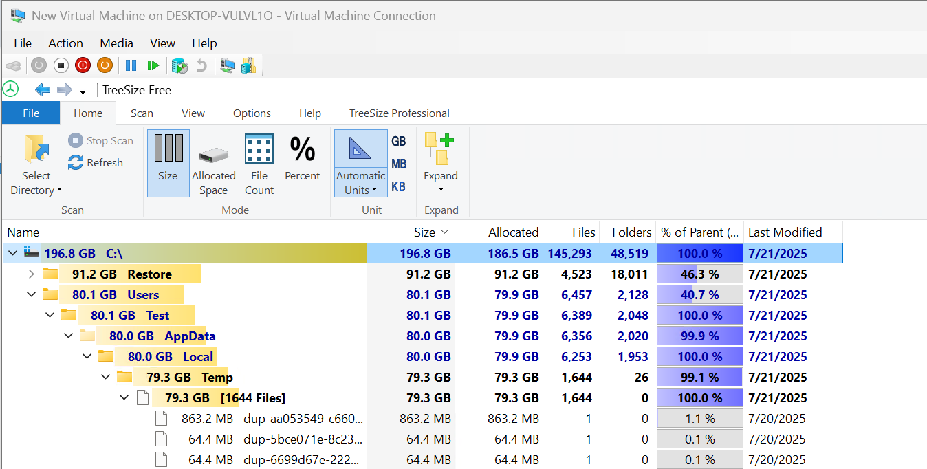

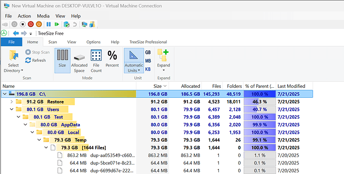

I’m redoing my DRP tests on 2.1.0.125_canary inside a virtual machine (to simulate a real full disaster condition), and I notice the restore process seems to fail (hang, actually) due to disk full. I had made the same operation on an older version and this problem did not occur.
You can find the log extract at the bottom.
There seem to be two problems:
It hangs rather than failing.
The disk was not supposed to get full, since I had ~50GB more free space than required for the restore. Judging by below screenshot, I am guessing the “cache” files are not deleted fast enough (or at all).
Summarized (and anonymized) log extract here. The last message with the “1, 1, 1” seems to go on forever
