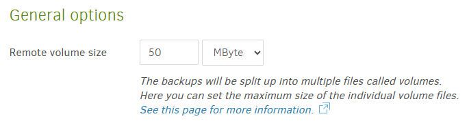

If you did that originally (which seems kind of hard to even see) what is Remote volume size?
That’s on the Options screen, links to basically the same article, and people often misconfigure.
Trying to put the whole backup into one file winds up filling up /tmp on the system Duplicati uses, however in a Docker case (I don’t use Docker), I’d have thought it would leave host space alone.

or you can look on your FTP server sorted by date. This will also hint at the Remote volume size, which I hope is something reasonable, as its default is 50 MB. If it’s local, you can go a bit higher.
