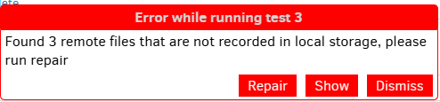

Sort of like below? Exact messages(or screenshots can help describe situations well.
I got that by deleting my job database on Database screen, then asking for backup.

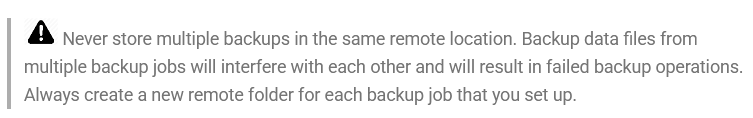

You always want a different folder for each backup. If you don’t, that’s probably the issue.
The new documentation doesn’t call this out (prior one did), but database works like this:

You always want a different folder for each backup. If you don’t, that’s probably the issue. … The new documentation doesn’t call this out (prior one did), but
Really??? I did not see that requirement described anywhere. If it was described, it certainly wasn’t obvious. Given that it can cause the catastrophic loss of a previously successful backup, that’s a major flaw. Not only should that requirement have been stated in a way that couldn’t be missed, but the program itself should have checked whether a previous backup had been saved to that destination folder and prevented that destination’s re-use. If the program can keep a database of what files have been processed, surely it can keep a record of where its backups exist. Other backup programs I have used always asked for a destination but then managed its contents without further specificity from the user. With so many zipfiles created in the destination folder I assumed the program would keep them properly identified. [FWIW, I am a senior software engineer, have been doing science application programming for over 40 years, have BS Physics Va Tech 1971, PhD Geophysics MIT 1983. If I wrote something that allowed a user to make that big a mistake it would never be accepted by anyone. I might even lose my job because of it.]

Old manual had more detail, including the warning below, but documentation isn’t a great replacement for protective code. Strangely, I can’t find any GitHub issues just on this.

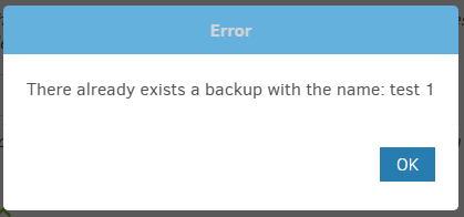

I exported a job and imported it to create a new one in same Duplicati. Try to save it, see:
Fix the name, and it saves with no complaint, so now I have two jobs with two databases. Import doesn’t import the old database path, which is probably a good idea), but sets the situation where two jobs with two databases think they both own one destination, so bad.

The web UI in 2.1 is a bit flaky for me, but I’m not seeing this, if I understand correctly.
There’s not AFAIK a show of the job name after the restore. It does show in progress.
and afterwards there’s a sometimes-optimistic success message in main screen area.
Status bar returns to idle state, giving the schedule status for next job, or saying none.
Problem needs more information, but so far I can’t repro any kind of wrong-name bug.

Not seeing it, but it might depend on options. Database screen DB Delete, then backup:
Found 9 remote files that are not recorded in local storage, please run repair
It would work after a manual DB recreate (by Repair with no DB), which is inconvenient.

2025-04-26 09:59:42 -04 - [Warning-Duplicati.Library.Main.Operation.BackupHandler-BackendVerifyFailedAttemptingCleanup]: Backend verification failed, attempting automatic cleanup
RemoteListVerificationException: Found 3 remote files that are not recorded in local storage. This can be caused by having two backups sharing a destination folder which is not supported. It can also be caused by restoring an old database. If you are certain that only one backup uses the folder and you have the most updated version of the database, you can use repair to delete the unknown files.
Some information from the databases:
OOVJUVUXHA.backup
Operation table
Backup          9:59:42
Repair          9:59:42
OOVJUVUXHA.sqlite
Operation table
Recreate        9:59:46
Repair          9:59:48
Backup          9:59:48
Backup          9:59:50

I have not read through any manual, so if it contains a warning then I have not seen it. The fact is, this UI seems so intuitive that most users, including myself, will probably try to use it without reading any manual. So a warning in a manual is not a solution.
I just tried another experiment. I created and successfully ran a test backup. Then I created a second backup with the same name and same destination. The screen reported that a backup with that name already existed and it would not let me continue. That’s good. I then changed that backup’s name but left the destination the same. It let me save and run it but first gave me the Please Repair message. I did not pay attention to the exact error, only that some filenames somewhere were missing or unexpected. The exact wording isn’t clear enough to tell me what the problem is, and the invitation to fix it with Repair is a dangerous suggestion. I then tried to restore a file from the original test backup, and as expected it gave me an error about the restoration file missing. This is exactly the behavior I saw originally, so no surprise. I checked for a Duplicati update and got none. If you have added error messages to an unreleased or beta version I wold not have seen them.

I agree. For now I have made a change to the next version that will state this problem if you click the “Test connection” button. It will then detect existing backups in that folder and tell you not to do it.
We can consider if the Test click should be mandatory, or at least nudge you towards it (like: It is highly recommended that you test the connection, do you want to do it now?).
There is a small corner case: if you create the backup schedule, but do not run any backups, the folder is empty, so a second backup configuration will not detect it. Once you start running the backups, it will be the same outcome as you describe.
