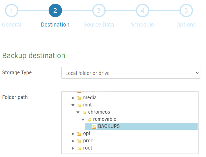

I’m trying to configure a new backup to a local external hard drive. I have selected local folder or drive but the folder path does not show my external drive which I have shared with linux. Can anyone please help?

Sharing files to Linux suggests you should look for a share at /mnt/chromeos

Did you look in /mnt/chromeos
using file browser, ls
command, cd
command, etc.?
Google search for “external drive” “/mnt/chromeos” has advice and suggests it goes in:
/mnt/chromeos/removable/$drive_name
and then says to navigate there, like my step 2, which in Duplicati means some clicking:
Above is just some subfolders I made as root
in /mnt
per reporting of how it would go.
If yours isn’t going (step 1 on my list), that’s a different issue that likely no backup can fix.
