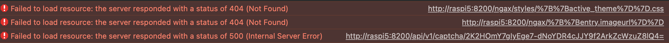

Thanks, so this is the error messages about not displaying the captcha:
The error “500” means the request causes a failure inside the server. For security reason the real error is not reported to the browser, but should be visible in the Docker logs?
