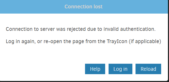

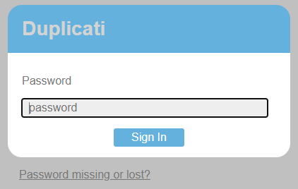

What happens when you use “Log in”? Do you get the screen below? What do you do?
Note that there’s a help link at the bottom of the screen. Changing password is easy if TrayIcon will get you in first (so I want to hear more about that step). If not, it’s harder.
