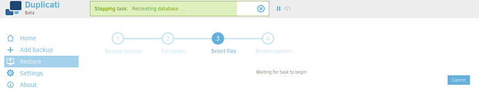

One problem solved, another created. I finally moved ALL of the backup files to a USB HDD and I can access that with Duplicati:
However, on the next step, I get:
Forever. Nothing ever happens.
What now??
Please see what’s happening at About → Show log → Live → Verbose (or Profiling if Verbose is quiet)
I’m not sure what happened. I think I was just not patient enough. I tried the same Restore this morning and it worked! It took 15-20 minutes on some steps (recreating the database and finding files) but I walked away and when I got back the Duplicati reported success and indeed the files were all there.
