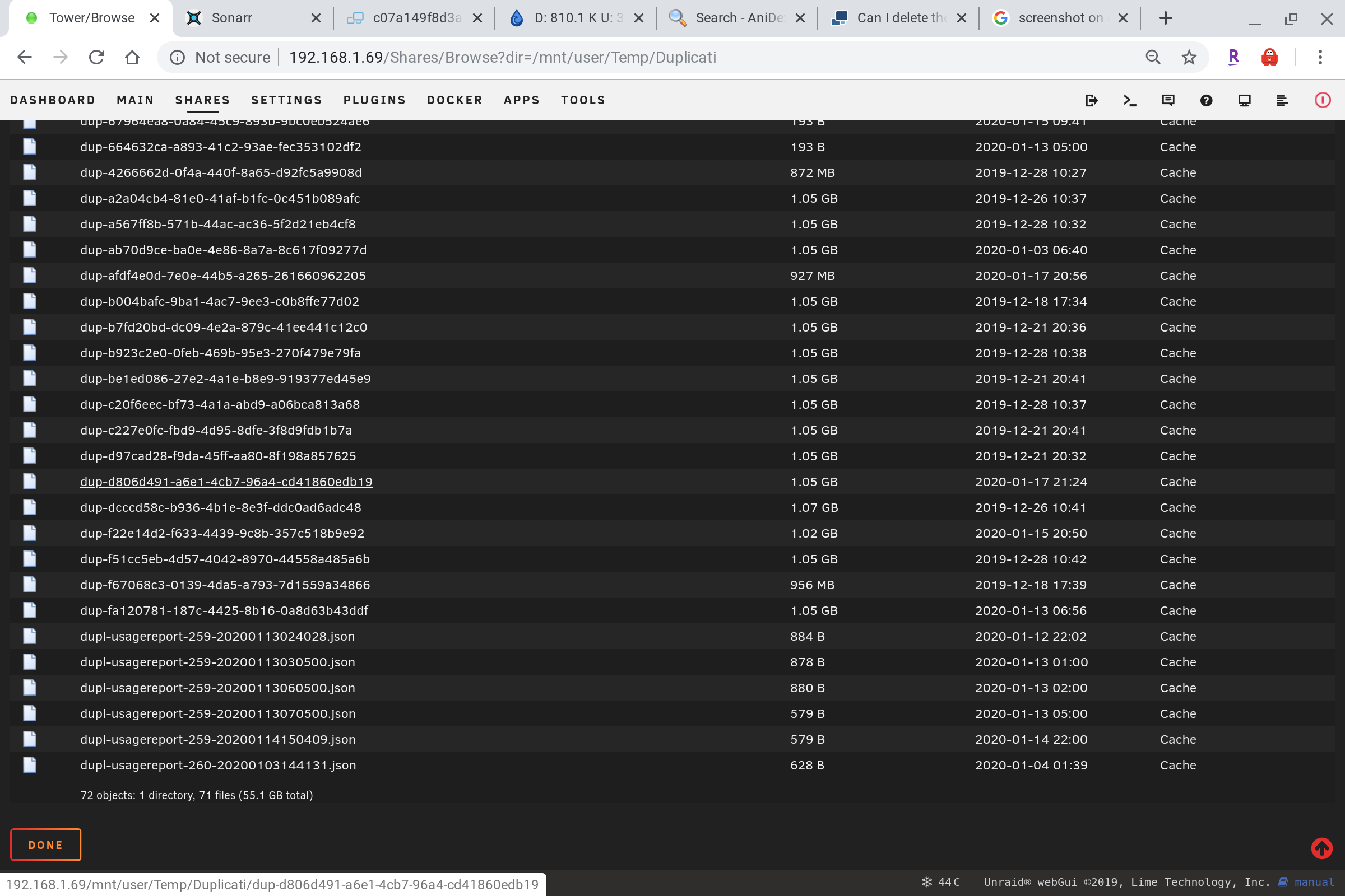

In my temp folder, which I have mapped to my cache, I have a ton of files that start with “dup-” and then are followed by a random string of letters and numbers. I think these are what are uploaded when I am backing up, and there is a backlog of them from the multiple times that duplicati has hung on an upload and needed to be restarted. Is it ok to delete these? I don’t want to mess up my actual backups.
There is also one .sqlite file, and five .json files. I have 5 seperate backup templates, so I am guessing the .json files are for those. And the sqlite is the database? So I guess those should be left alone? But the other files are rather sizeable. Do I need to keep them?

I have never done an actual restore, not a full one anyways. After an upload finished, I have run a restore in that specific backup profile for individual files to make sure they would work. But I don’t know the exact date. And the date on the file is almost a year ago. Don’t think I ran any then. Again, there is just the one sqlite file. There are 5 .json files. and then there are 65 files with no extension. There is also an empty folder labeled HttpServer.

So, I assume that means I can delete the “dup-” files also right? And I should leave only the .json files?
If Duplicati has no active job running, I think you can delete all the dup- files and even the json files.
