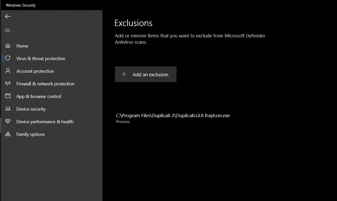

I don’t consider this a permanent solution, but a workaround I found was to exclude the “Duplicati.GUI.TrayIcon.exe” process from Windows Security real time monitoring.
At least that would make it clear where the problem lies. But yes, until a deeper fix is found, I guess it would need to be off.

Sounds like a decent compromise to only exclude one executable from the list.

  • Added Duplicati as an exception from real time monitoring in Windows Defender/Security

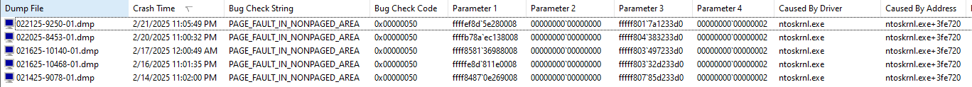

mini_dmp_files.zip (1006.7 KB)
There’s the last 5 minidump files.

Meanwhile, I might try BlueScreenView on your minidumps. It’s easy, but doesn’t give much detail.

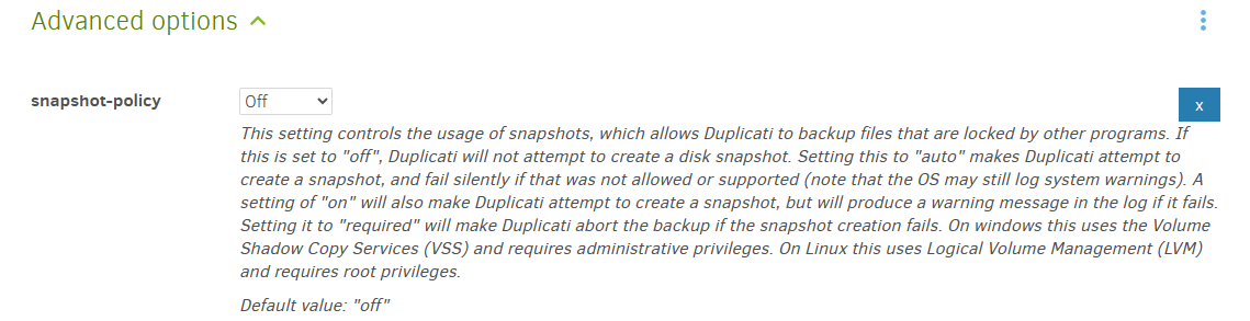

Are you by any chance using VSS via the snapshot-policy option? If so, does turning it off help? Sorry about requesting tests that might crash the system. You can also test a small backup to see whether there’s something special about the BSOD backup that leads to the BSOD. You could run log-file=<path> log-file-log-level=verbose to see if it’s consistently around a certain place.

As noted, BlueScreenView is pretty basic, but here’s what it has to say about your minidumps:

I don’t know for sure that Duplicati won’t go to AlphaVSS for other things, but I kind of doubt it.

But since the crash has gone into hiding, it will be hard to find what did it in this way, and if it did crash, then the question would be whether File --> Backing files would catch the end of it.
Turns out it was my display drivers causing this. M. Night Shyamalan has entered the chat…
After updating my display drivers, backups proceed with no BSOD. I’ve seen some posts about updating my display drivers but didn’t do it until now because the minidump files didn’t indicate anything about it. Also I had my display drivers for more than a month before it apparently became a problem.
On a side note, I couldn’t use the most recent drivers because it would result in a non-responsive black screen at login. I was lucky that there was one driver after the one that started all this but before the most recent one I could rollback to.
Anyway, I’m tired. I won’t mark this post as a solution for a few days, in case it does come back again and this was another red herring T_T
