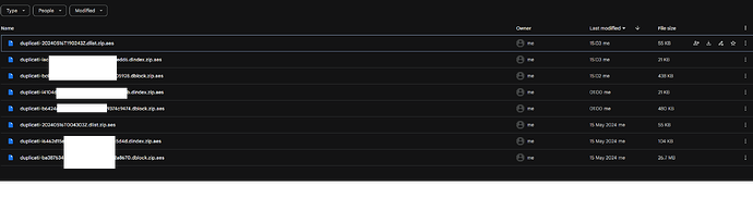

I am new to Duplicati. I installed and ran the backup job. It created ~27MB file during the first run. Second and third run are creating in KB size files only.
  1. I expected every day the file size going to be increasing/similar. Is it capturing only the changes?
  2. In case if my Ubuntu server fails and I end up re-installing Duplicati, how it knows I have the backups in my google drive? Now the current version automatically shows I have two backups. If I do fresh install and connect to my google drive, will it recognize on its own?

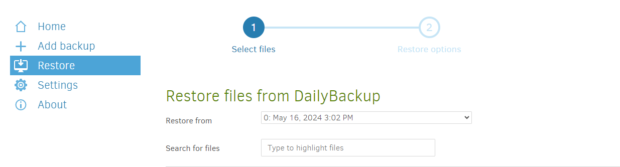

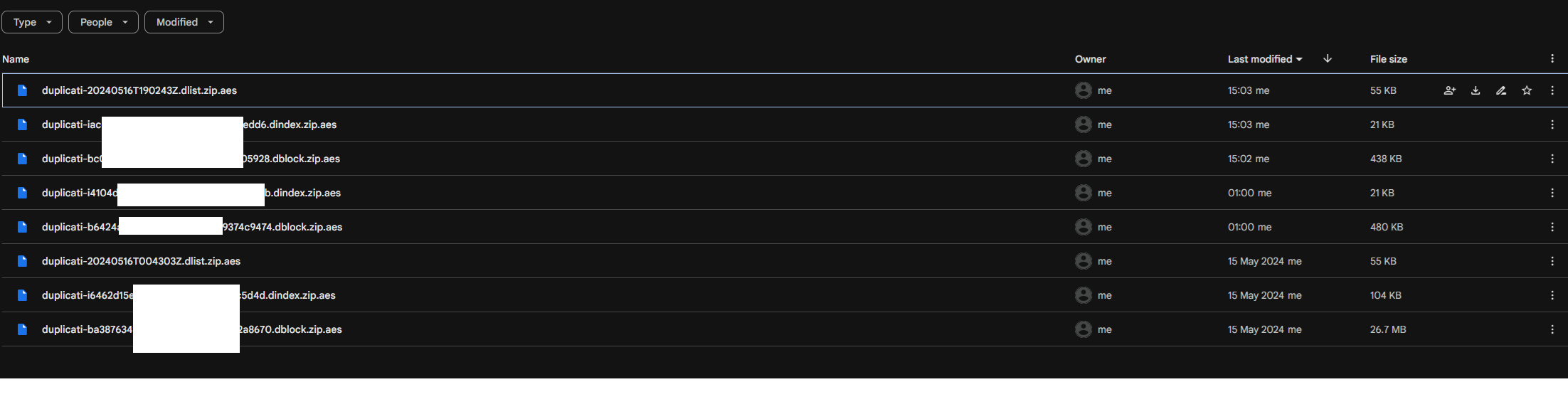

It shows only two versions in the Web even though it created files every day in my google drive. Web has initial (two days back) and latest version (today). But yesterday it had an initial and yesterday version.
I used the smart backup option. it was supposed to create backup for 7 days, 4 weeks and 12 months. Not sure on the exact thing, but something similar to this it was supposed to create as per the options I had chosen.

Not exactly. See the “one backup” note:
So if you take too many backups per day, something will get deleted to leave a density of one per day.
Your May 16 backup might have been less than 24 hours from your May 15, so therefore was deleted.

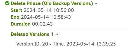

This should all be in the job log, for example:
The current screenshot shows some files, but not a dlist, which represents a backup version, and then
shows that it used to be there, so look at third backup log to see if it deleted second. That deletes a dlist.
