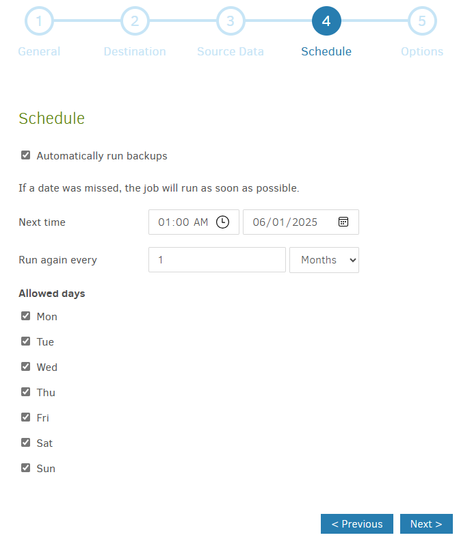

The closest you can get is to set the next time to June 1st, and then set the time between backups to 1 month. Because Duplicati uses actual calendar months, this should give you a setup where the backup runs on the 1st of each month.

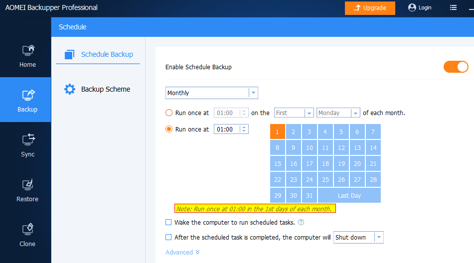

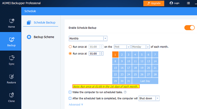

For example I have installed “Aomei Backupper” in parallel and there it is possible “out of the box”:

True for Duplicati too, at least for the case you set.

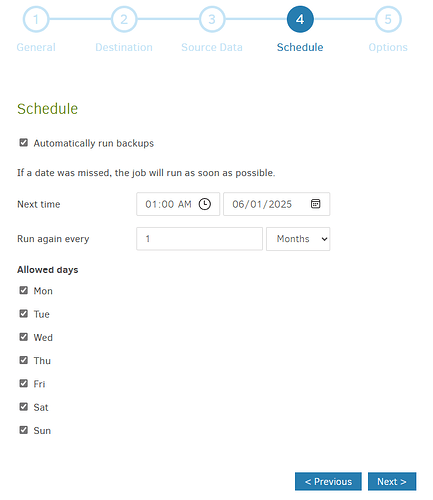

Documentation at Set up a backup in the UI covers Schedule page:
“Run once at 01:00 on the 1st days of each month”
Assuming that a month works as described (and it seems to), that’s:

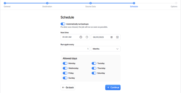

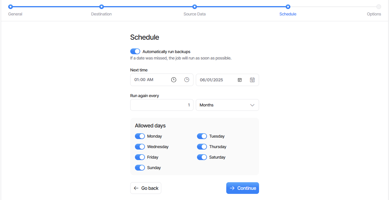

or in the upcoming new UI now in Canary test:
