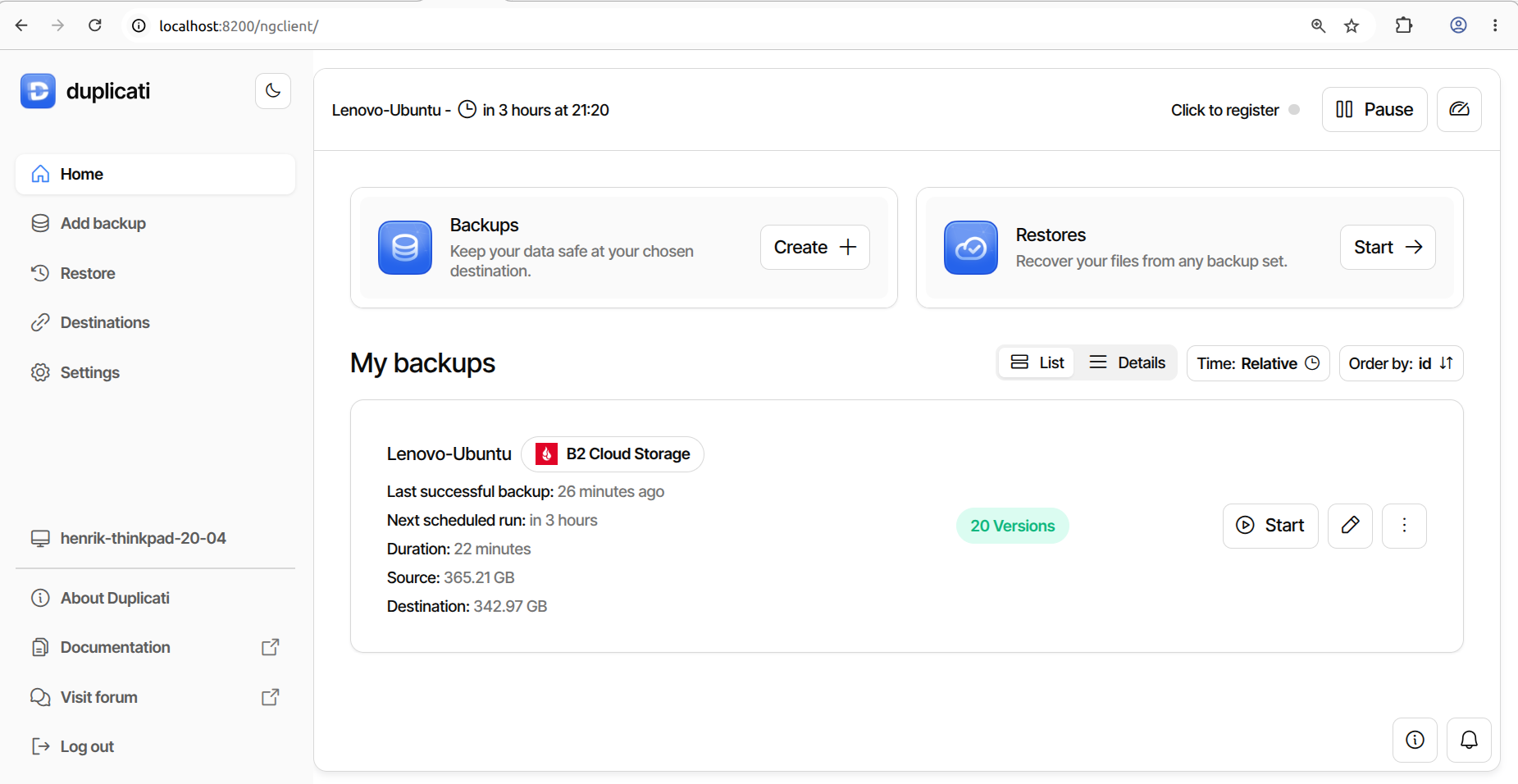

I do not have a 3-dots-menu. This is my screen (in Chromium, on Ubuntu):
You do when the job isn’t in the middle of running.
During run, you get an appropriate set of displays.

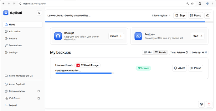

BTW you can click the red icon to see what it has:

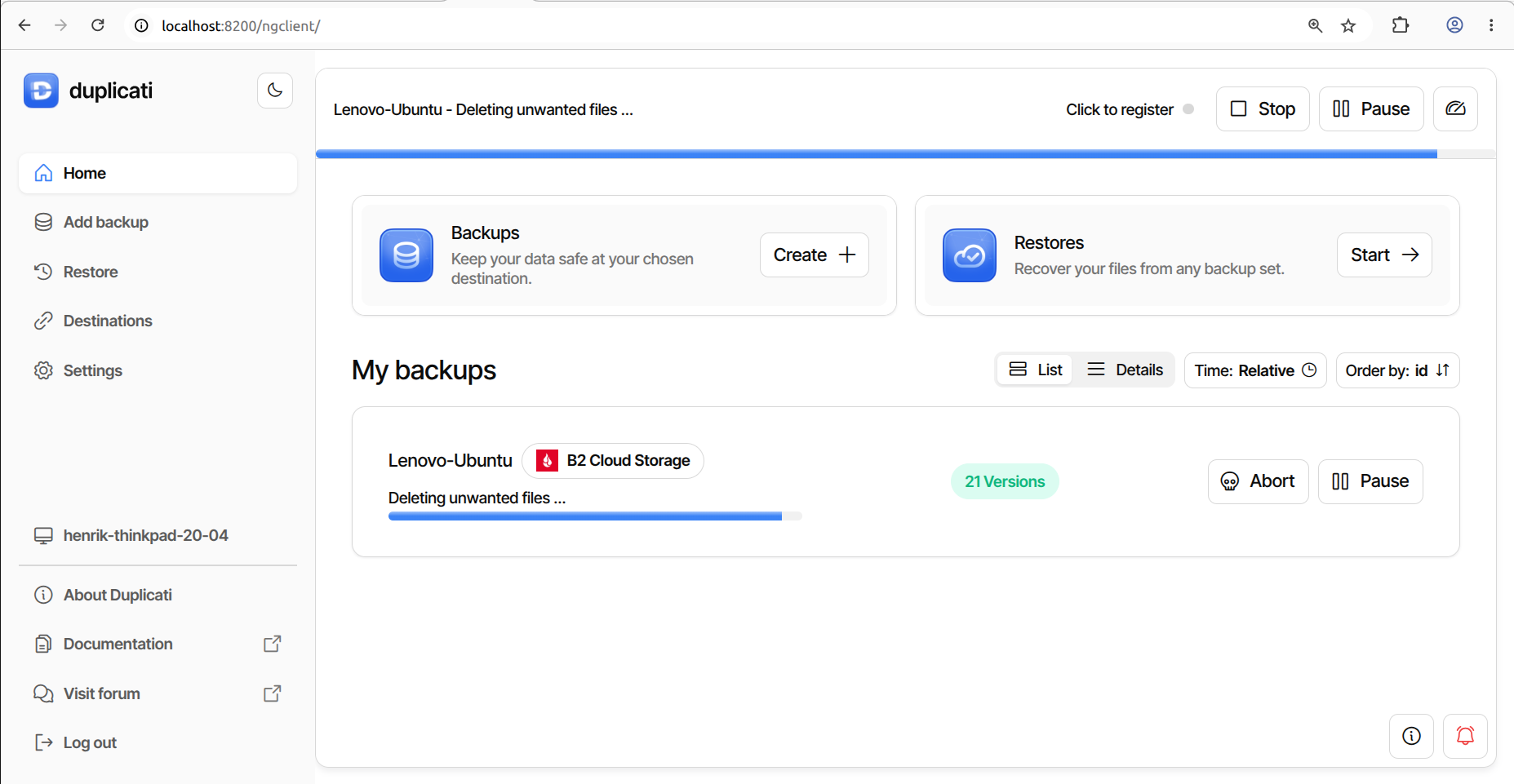

I cannot make the job finish… I have tried the Stop-button.
BTW: The only message on the red bell is this:
"Unencrypted database
The database is not encrypted. This is a security risk and should be fixed as soon as possible."

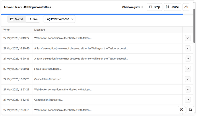

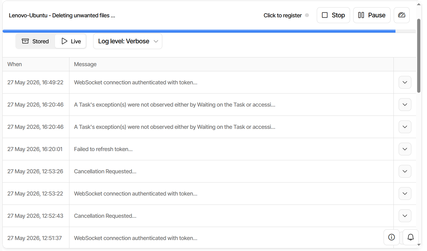

Here comes the Verbose log:
I read it (maybe wrongly) as the automatic hung, then manual was for debug.
If manual was first issue, you can kill the process because Abort doesn’t work.

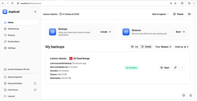

I still would like to run some kind of repair, to ensure that the local database does not think that the B2 cloud server contains something that is not there! But I still do not have any 3-dots-menu! See this screen shot:
Always nice to have that, but I guess we don’t know much about last time now.
Here it is from your screen shot, on the far right of image below:
You would click the three dots icon to get it to show you its menu.
