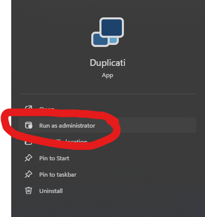

When running Duplicati as admin, backup and verify files work normally.

It’s also when Windows wakes the system if necessary, and runs Windows Update work, potentially interfering with Duplicati. I’m assuming you didn’t “Run as administrator” then. For that test, do you set up during daytime, then it avoids issue at 3 A.M. GUI schedule?
“Run as administrator” is smoother if account is already an administrator, as it enables its special powers by elevating. If not an administrator, it needs to ask admin and password.

It sounds like you must have restarted Duplicati in order to test a “Run as administrator”.
