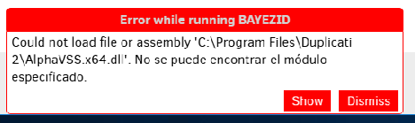

Duplicati error starting to backup:
Error: Could not load file or assembly “C:\Program Files\Duplicati 2\AlphaVSS.x64.dll” No se puede encontrar el modulo especificado.

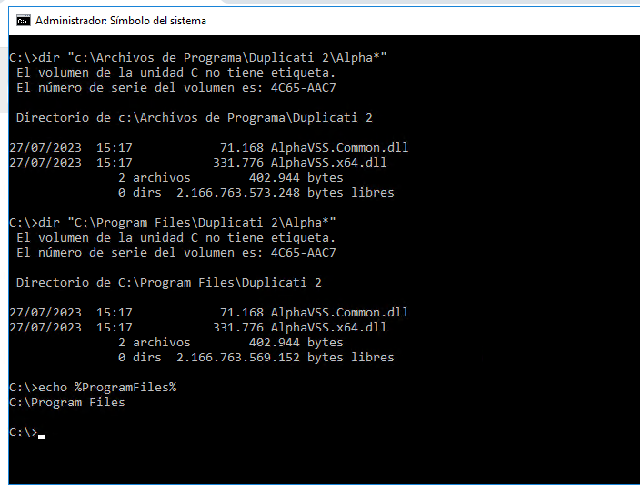

Here is the File as seen by the OS:

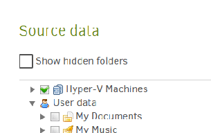

2- Quad user cannot see the HyperV machine list menu list, but administrator user can.

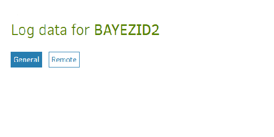

4- tried enabling verbose logging and debug log, but no messages are shown. perhaps the options are not intuitive?
5- installed Duplicati on its own path, as the user administrator. (C:\Duplicati2) to avoid any issues with language paths. same load error about AlphaVSS.

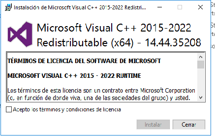

Fix for the AlphaVSS. This particular host did not have installed the C++ runtimes so I installed them and the AlphaVSS.x64.dll error is gone.
so it seems the language is not a problem. The runtimes where the issue.
