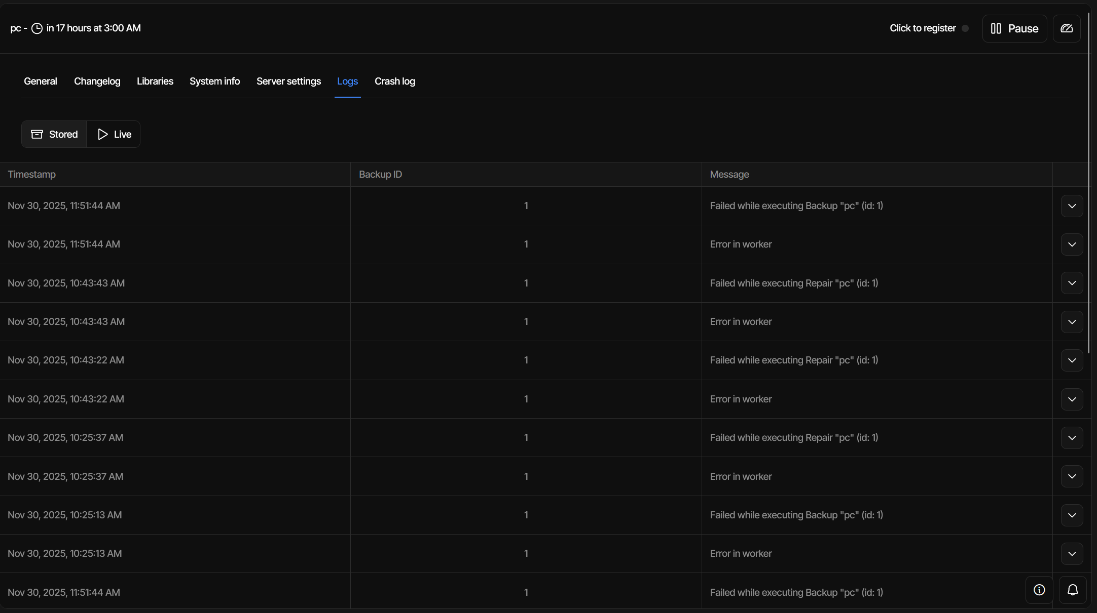

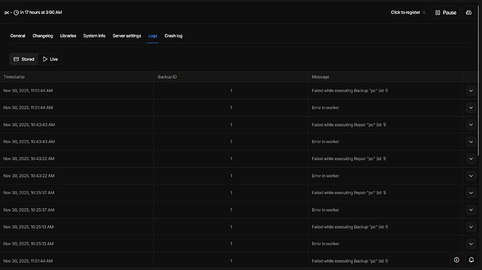

Hello,
I went to the logs (/about/logs/stored), and noticed they are kinda old, end of Nov. 2025.
When do these update? What logs are kept here that I would expect to see this update from time to time?

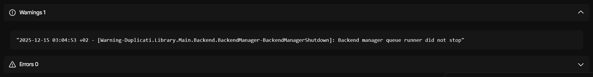

I mean, for example, I had Duplicati show a warning the other day, so I would have expected this to be mentioned in the Logs under About Duplicati, no?
So why have the logs stopped on Nov. 30th? About two weeks ago.
I think no. For ordinary warnings and errors, check the log for the individual job, which is where button to show the log sends you. Sometimes the better answer should be to check the server log not the job log. The dev explained it as below:
Configuring logging
Duplicati will log various messages to the server database
which to me isn’t very informative, but my experience is it logs things that aren’t related to job, or extreme things that are related but which usual job log misses.
