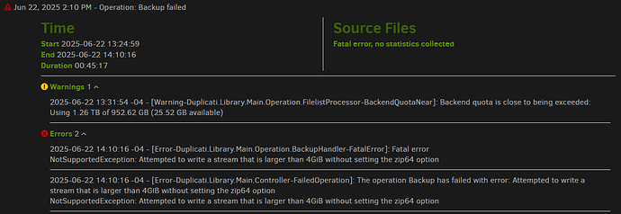

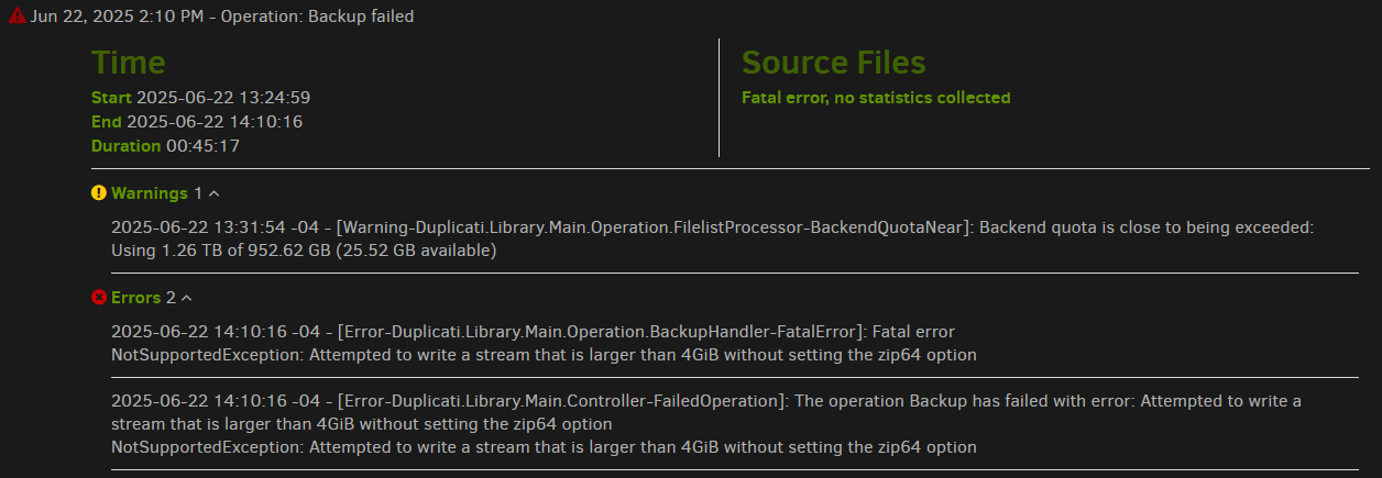

I have a backup with a lot of files, and some of the files are large (more than 4 GiB). I did set the “zip64” option to True. Duplicati version is 2.1.0.5_stable_2025-03-04.
However, when I run the backup, it fails with the message “Attempted to write a stream that is larger than 4GiB without setting the zip64 option”:
What am I doing wrong? Is there any way to fix my configuration without splitting it into multiple backup configurations?
The complete log doesn’t seem to be shedding any light on what might be going on:

"2025-06-22 13:24:59 -04 - [Information-Duplicati.Library.Main.Controller-StartingOperation]: The operation Backup has started",
"2025-06-22 13:31:54 -04 - [Information-Duplicati.Library.Main.BasicResults-BackendEvent]: Backend event: List - Started: ()",
"2025-06-22 13:31:54 -04 - [Information-Duplicati.Library.Main.BasicResults-BackendEvent]: Backend event: List - Completed: (5.04 KB)",
"2025-06-22 13:31:54 -04 - [Information-Duplicati.Library.Main.Operation.FilelistProcessor-KeepIncompleteFile]: keeping protected incomplete remote file listed as Temporary: duplicati-20250305T202859Z.dlist.zip.aes",
"2025-06-22 13:31:57 -04 - [Information-Duplicati.Library.Main.Operation.Backup.UploadSyntheticFilelist-PreviousBackupFilelistUpload]: Uploading filelist from previous interrupted backup"
"Warnings": [
"2025-06-22 13:31:54 -04 - [Warning-Duplicati.Library.Main.Operation.FilelistProcessor-BackendQuotaNear]: Backend quota is close to being exceeded: Using 1.26 TB of 952.62 GB (25.52 GB available)"
"2025-06-22 14:10:16 -04 - [Error-Duplicati.Library.Main.Operation.BackupHandler-FatalError]: Fatal error\r\nNotSupportedException: Attempted to write a stream that is larger than 4GiB without setting the zip64 option",
"2025-06-22 14:10:16 -04 - [Error-Duplicati.Library.Main.Controller-FailedOperation]: The operation Backup has failed with error: Attempted to write a stream that is larger than 4GiB without setting the zip64 option\r\nNotSupportedException: Attempted to write a stream that is larger than 4GiB without setting the zip64 option"
